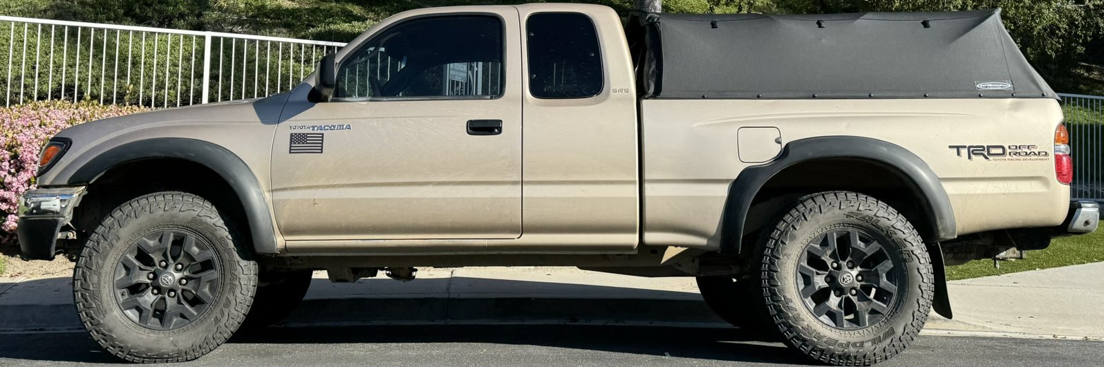

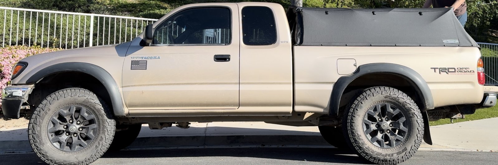

    Hello forum dwellers. I have a bed rack system and RTT delivering soon which will put roughly 230lbs of load on my axle-wrapped 2002 OEM leaf springs.... I know.. I know.. you might be wondering why I went for a tent before a lift. We'll save that discussion for another day :)
    Anyways, I have two pictures of my truck, one in its current stance, and one with roughly 230lbs in the back (bro squat activated). It's definitely not ideal, but I wanted to hear yall's opinion- should I get an AAL right away? Should I drive around and see how it feels off road first? I've been eyeing an OME lift for months now, and I may just pull the trigger on that.
    BEFORE WEIGHT:
    AFTER WEIGHT:

    As for the squat amount - it looks fine. But the weight will be higher and make driveability something you'll want to consider. But for driving out to it, and enjoying things? It'll look/be fine.

    looks good to me.

    Looks fine but this will shorten the life of the leaf springs. If you’re going to have this plus a lot of gear in there frequently you may want to upgrade eventually to something rated for higher constant load.

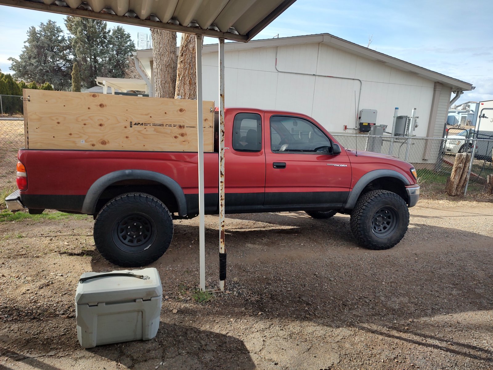

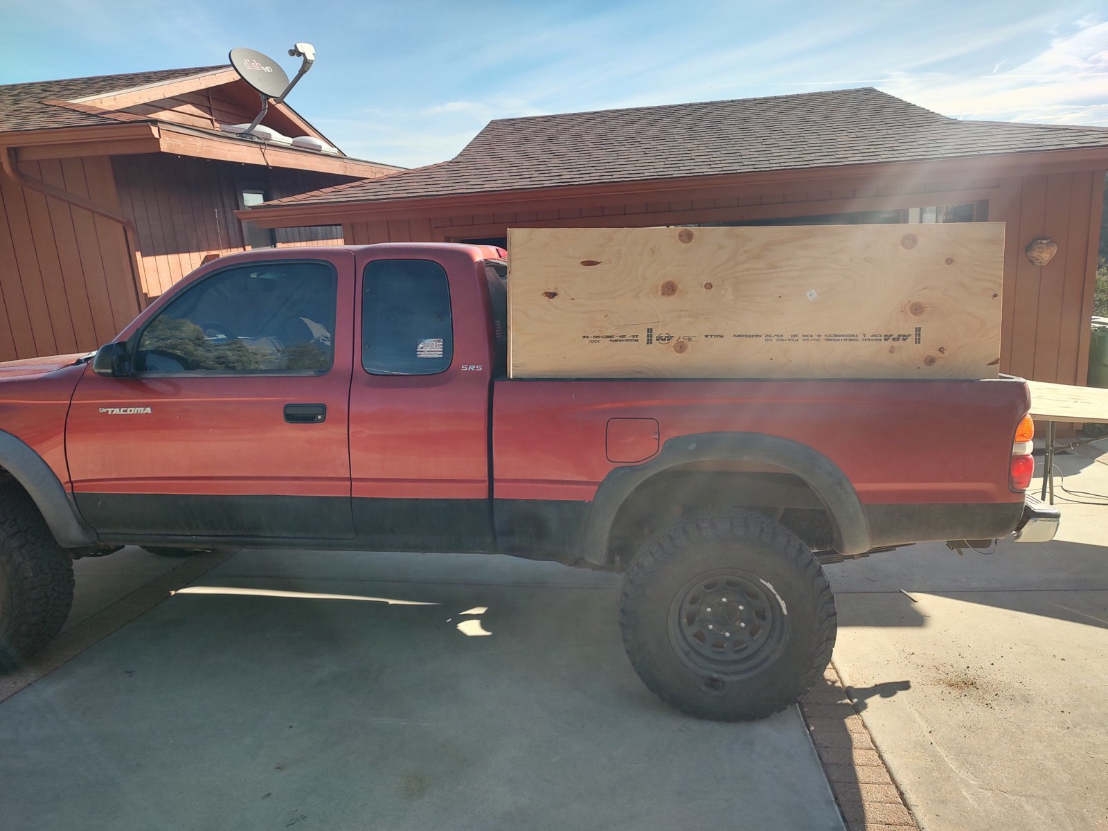

    x2 for going with Alcans.
    Here's them unloaded (except for my plywood box):

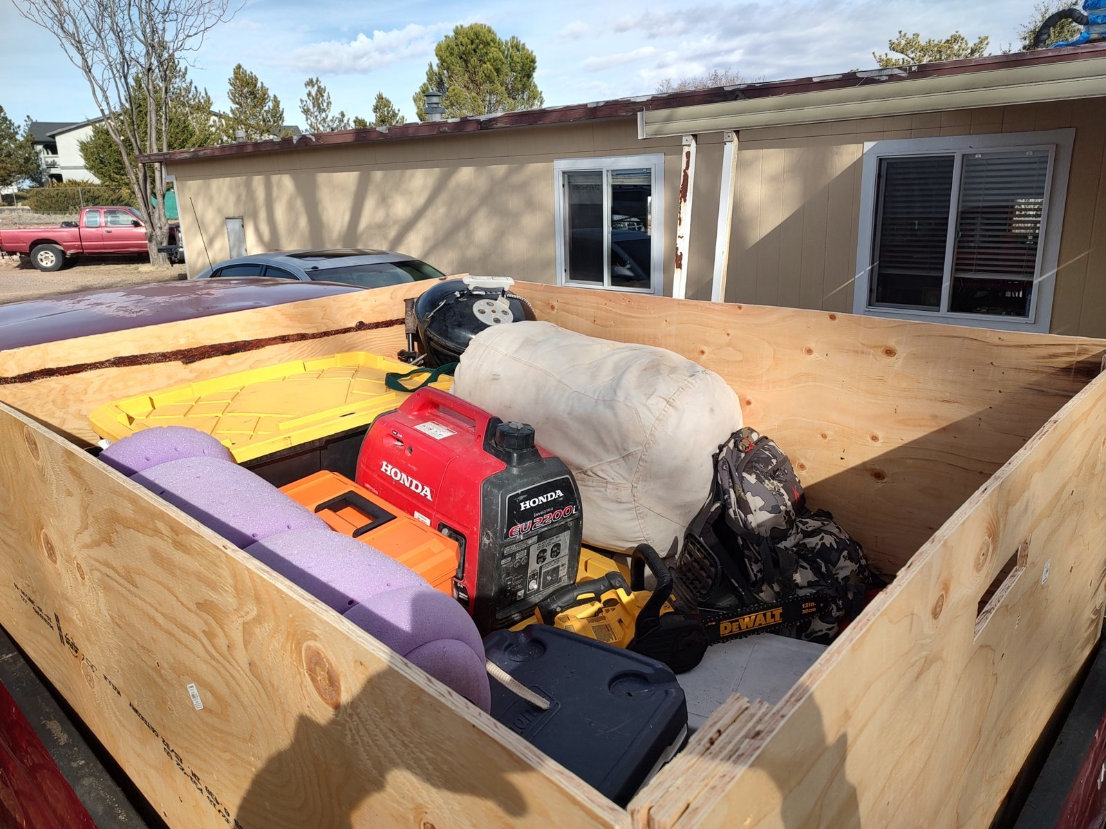

    And here's them loaded down with ~500# of camping gear:
    They ride quite well unladen, and incredibly well loaded down.
