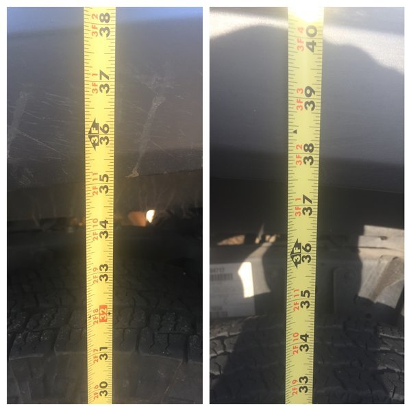

    Stock TRD OR, stock tire/wheel size, camper shell. ~ 3/4 tank
    Attached pic is of the rear heights.
    Passenger side ~ 2.5" higher than driver side.
    I've heard of the Taco Lean but 2.5" seems outrageous to me.
    Post yours!

    Take your measurements center of hub to fender

    Something is wrong with your measurements... taco lean if it's over 1/2" you have another issue, like and chassis bushing or mis-aligned bed. Or someone whacked your truck in the back in a parking lot and you are not aware of the damages yet.
    I watched a car in front of me rear end another car in front of her. The whole car came off the grown all 4 wheels; the car that she ran into, I couldn't tell there was any damage. They were going very slow... I couldn't believe how high off the ground the rear car lifted.. boom... 3 cars were involved in front of the offending vehicle... none of the cars looked visually damaged.

    My taco lean was maybe 1/4 inch after a few years of owning it. I got a top place spacer and it fixed the issue.

    yeah i can handle 1/4" but 2.5"...nah

    Don't measure while your wife is sitting in the Truck.

    Were you parked on a level surface? Sometimes when I'm parked on what appears level it'll lean like you have a sumo wrestler in your drivers side rear seat. Check it on a flat/level surface for accurate measurements? :notsure:
