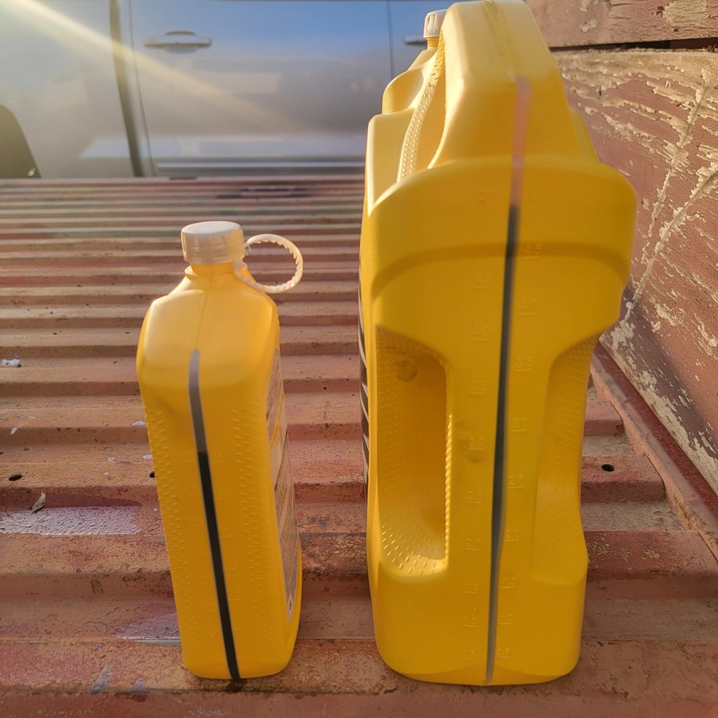

    Here is what I get out of my 3rd gen, approximately 6 quarts. And thats what i put back in even though i am missing .2 quarts20241206_163330.jpg

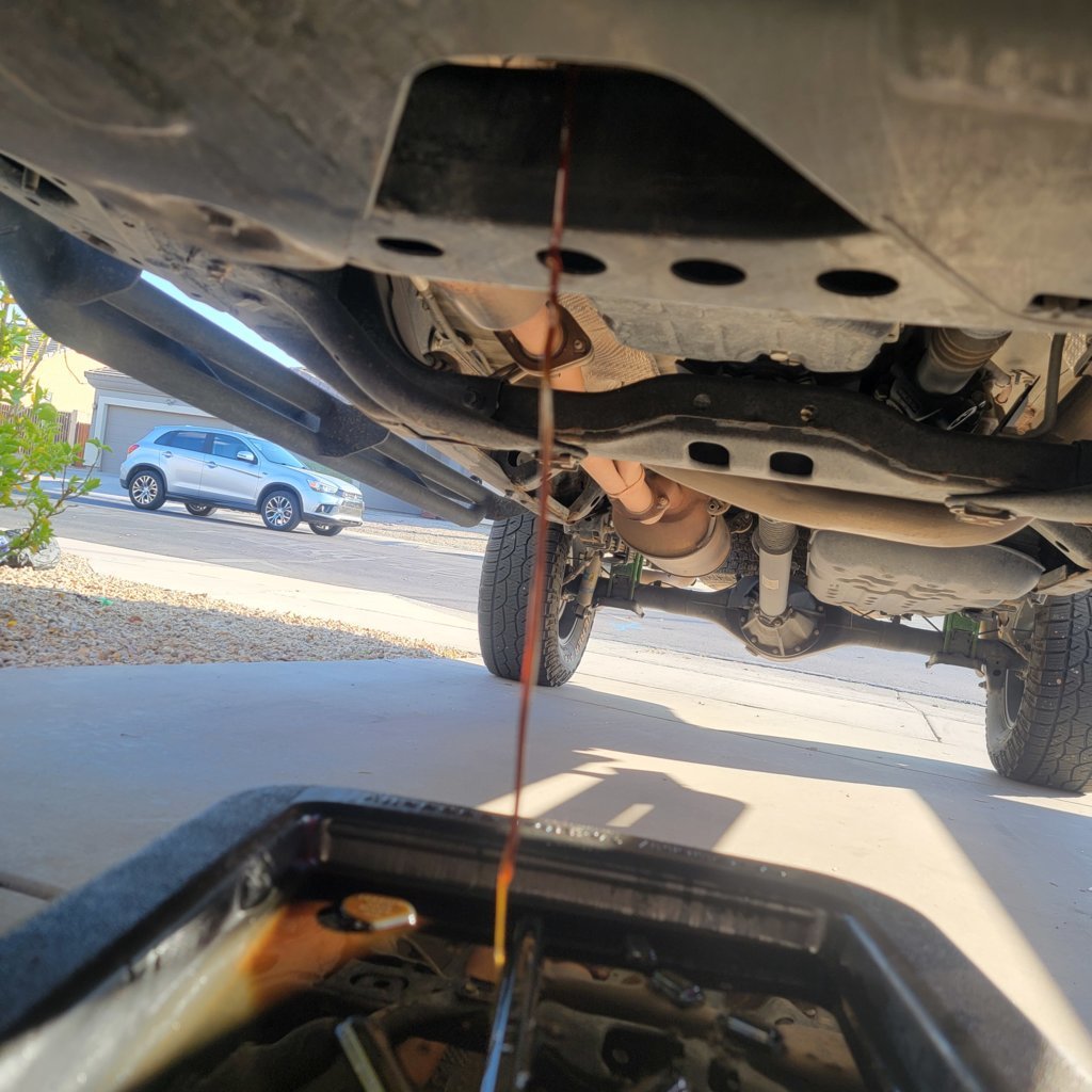

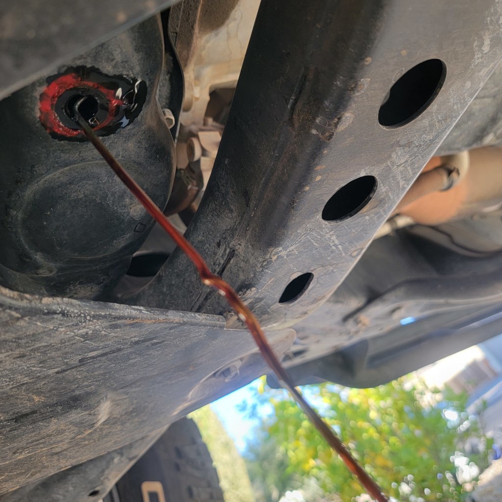

    Somewhere things I do is after the initial rush of oil comes out I put a coat hanger bent strait with a hook to hold it in place so I can leave it dripping for a few with out worrying about wind and a mess.20241206_152644.jpg 20241206_152620.jpg

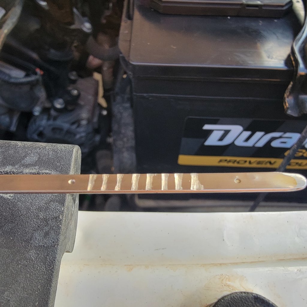

    Here are the hash marks I put on the dip stick but they don't help as much as the holes I suggested.20241206_164136.jpg
