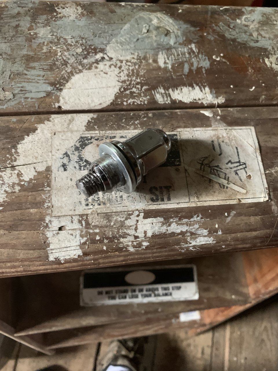

    No guarantee even at 83. I put this on in April. Brand new, torqued properly.
