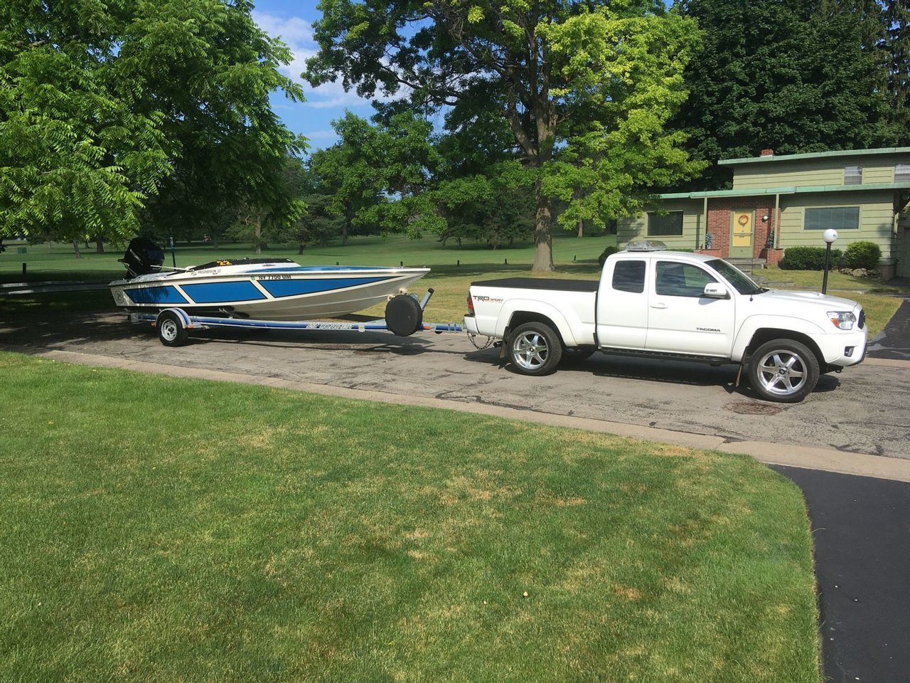

  3. Oct 28, 2020 at 9:11 AM
    Too Stroked
    Too Stroked Well-Known Member
    Jan 24, 2017
    #208501
    3,722
    Tom
    South shore of Lake Ontario
    2021 4Runner SR5 Premium
    Are you looking for the rated towing capacity or the realistic towing capacity? In my personal experience with Tacomas, there's a pretty big difference there.
    If memory serves me correctly, the rated capacity is a bit over 6,000 pounds. In the real world though, that doesn't matter because the Tacoma just isn't very comfortable towing much over 4,000 pounds. For instance, I have a 22' high performance boat on a single axle trailer (with brakes) that probably tips the scales at 3,500 pounds. That's well under the rated capacity, but I wouldn't want to tow much more. I just completed a one way 265 mile trip with the boat in tow and averaged about 10 MPG. The truck didn't like anything more than moderate hills even with the transmission in 4 instead of D. To put it another way, the truck wasn't very happy and never has been with the boat.
    If you go to a taller (less aerodynamic) trailer that weighs more, I think you're going to find it to be towable, but not fun. Just my 2 cents though.

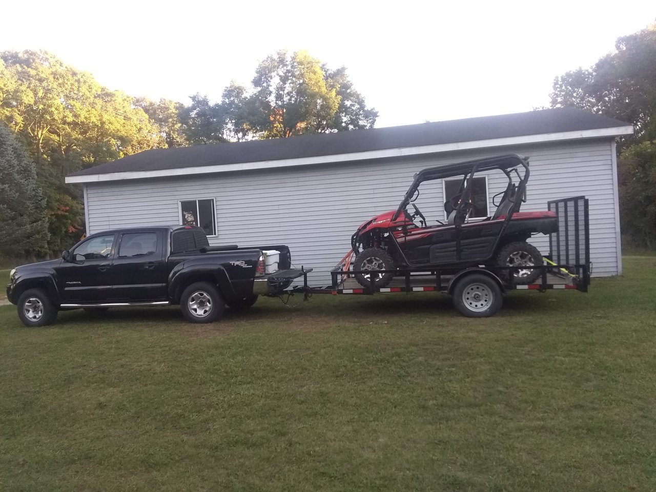

  11. Oct 28, 2020 at 12:23 PM
    nd4spdbh
    nd4spdbh Well-Known Member
    Oct 7, 2013
    #114055
    13,905
    SoCal
    13 DCSB TRD OR v6 Auto
    Yeah i think general consensus is 4000lbs fully loaded is about the safe upper limit of the small light tacoma.
    Rsmallw2[QUOTED] likes this.

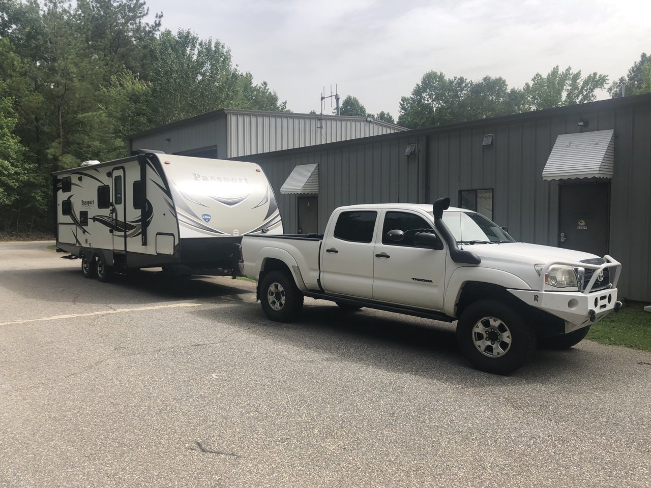

  13. Oct 28, 2020 at 12:34 PM
    medic2230
    Oct 13, 2008
    #9942
    63,981
    Murph
    Bama! Roll Tide
    4810 dry and 25’. Pulls like a champ but it will slow you down some on long inclines. Get around 8 mpg and I can’t figure out why the hell all you people want to load up the tanks with water. If you want to use the bathroom on the trip throw a few gallons in there. Should not be any reason for you to be hauling water and taking up load capacity with it. You’re just wasting gas. I never got in a hurry and drove 60-65. I’m running a 3” lift and 285’s on stock gearing. As long as you’re not going to be climbing mountains the taco will be fine with what you’re asking about. The main thing is everyone on here is different in their comfort zone of towing. We’re planning on moving up to a 5th wheel so I just bought a 3/4 ton to tow with. Now I use less than half the fuel towing the camper. It’s all about what you want out of it. I’ve towed a 4000 lb camper with the taco also. It was fine but we’re not the type to bring half the house with us to go camping.
    MadRiverTaco, Rsmallw2 and CygnusX191 like this.

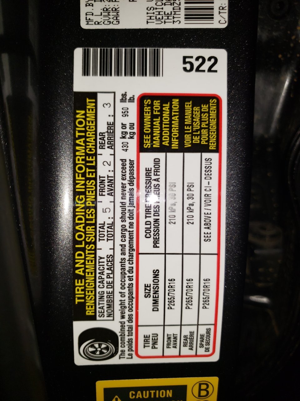

  15. Oct 28, 2020 at 8:39 PM
    bbaggett
    bbaggett Well-Known Member
    Aug 15, 2013
    #110540
    110
    Trophy Club, TX
    2013 Tacoma Limited DCSB 4x4
    6" Rough Country lift, 295/65R18 Duratracs
    Some Tacoma's only have about 950lbs payload including passengers, hitch weight, hitch, etc. Ridiculously low. What is yours?
    Lawfarin likes this.

  18. Oct 28, 2020 at 9:45 PM
    #18
    CygnusX191
    CygnusX191 Gangster of Boats
    Nov 29, 2016
    #203575
    17,327
    Timm
    St. Louis, MO
    So. Many. Stickers.
    3rd gens have a bit higher, 1100 or so but it's goofy since you lose 500lbs payload when adding 4x4 (yes I know, components = weight)
  19. Oct 28, 2020 at 10:16 PM
    #19
    bbaggett
    Aug 15, 2013
    #110540
    110
    Trophy Club, TX
    I'd have the 4x4 one, but that's nuts. I'm already balking at my F150's 1,574 lb payload lol.
    CygnusX191[QUOTED] likes this.
