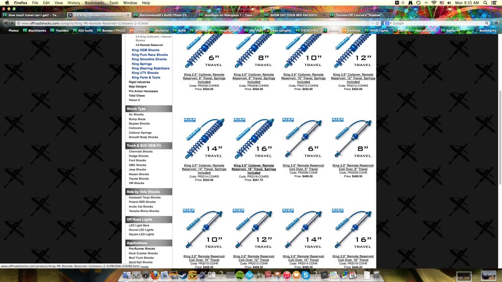

    Thanks a bunch! On 2 however, it says travel length, with overall shock length pushing something like 30"
    fd26ed54-e553-45b3-ae3d-f73fe0a454da_zps_8bb5d29af88c0d127a96025f4d69736b1bd26df7.jpg

    Alright, so if I have this correct, travel stays the same unless I have LT, which keeps me around the 8" range? The last ones listed, the 16", are just for those absolutely crazy builds? And lastly, my lifting will only decrease the travel?
    That all sound right?

    You'll still have the same "travel" if you lift. You'll have less down travel the higher you go but you would have more up travel. Travel stays the same, your just changing your ride height.
