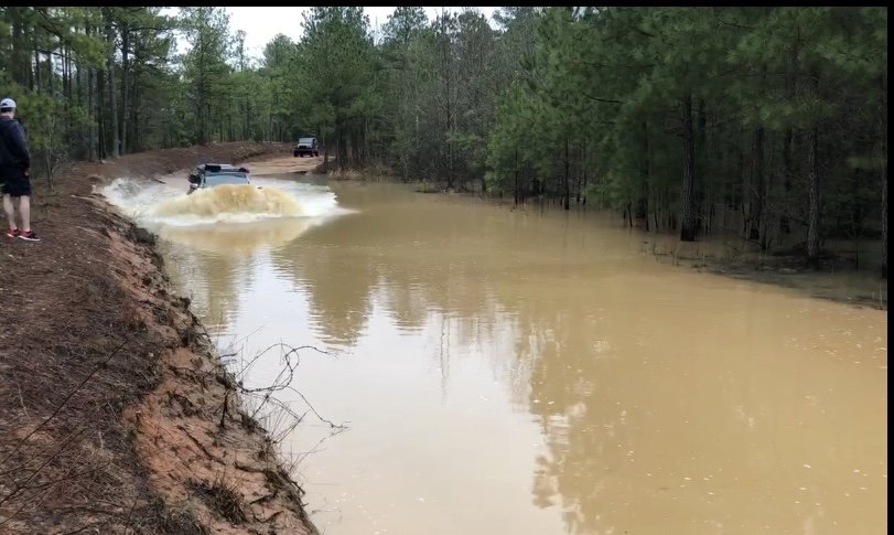

    As deep as you want. But only once.
    Jokes aside, I won't go much deeper than the top 1/3rd of the tires. My snorkel is primarily for cooler, cleaner air. I will avoid water when possible. That said, I have temporarily gone headlights deep but I knew the front end was going to be coming back up before the depth of the water would be an issue.
    Fording can be done but you've really got to be built for it.
    https://www.youtube.com/watch?v=BiTKh9R1BhI
