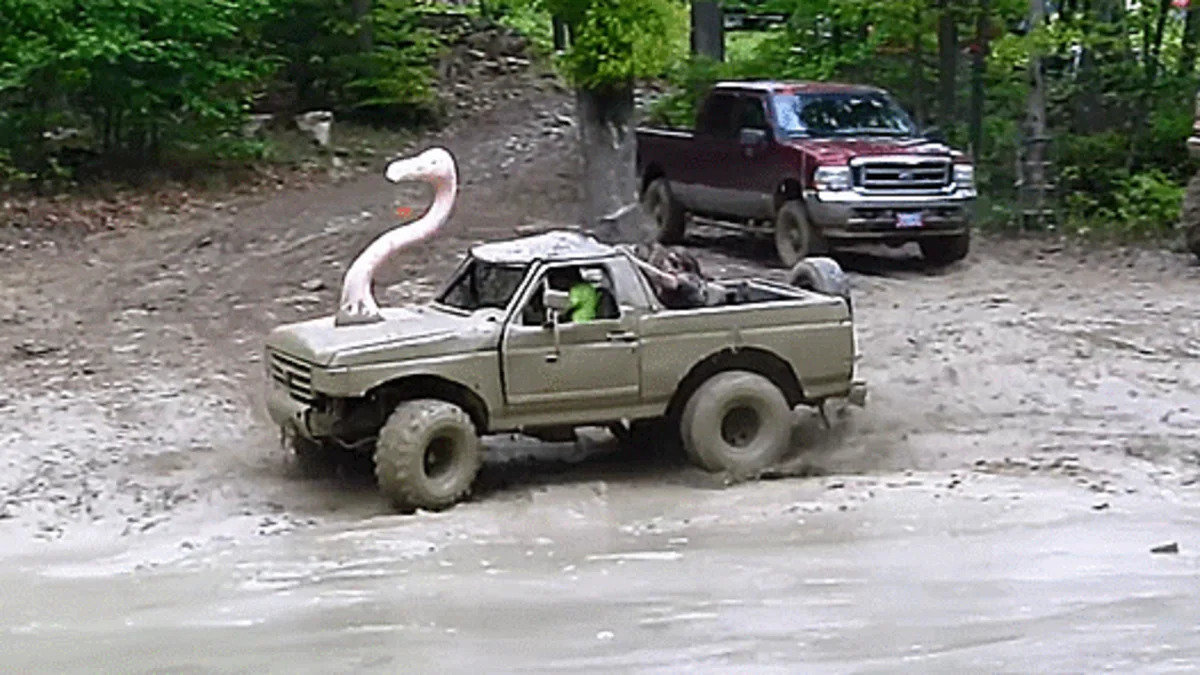

    You got something like this?:D

    Tacoma1997White4x4
    Tacoma1997White4x4 America First
    Sep 15, 2019
    #305397
    1,031
    West Covina, California
    1997 white 4x4 auto 4cylinder Singlecab, 2001 auto rwd 2.4l single cab flatbed
    Km3’s 31’s,Lift,Sliders,rear ARB air locker,on board air, armor, hi shell
    Lol thats real?
