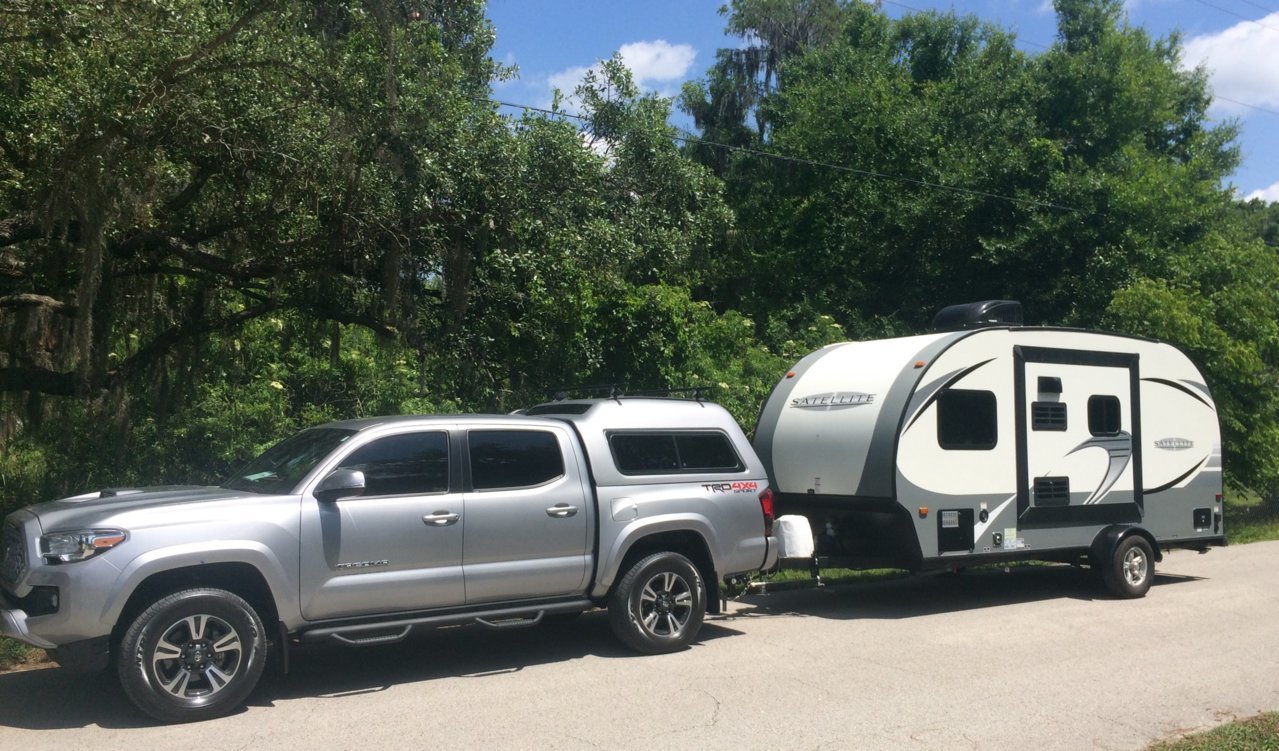

    Of course it will beat the truck. I tow with mine. I also have the dealer follow the “towing” maintenance schedule on the Owners Manual. I have a similar setup. I’ve got about 6000 miles towing and all’s good.
