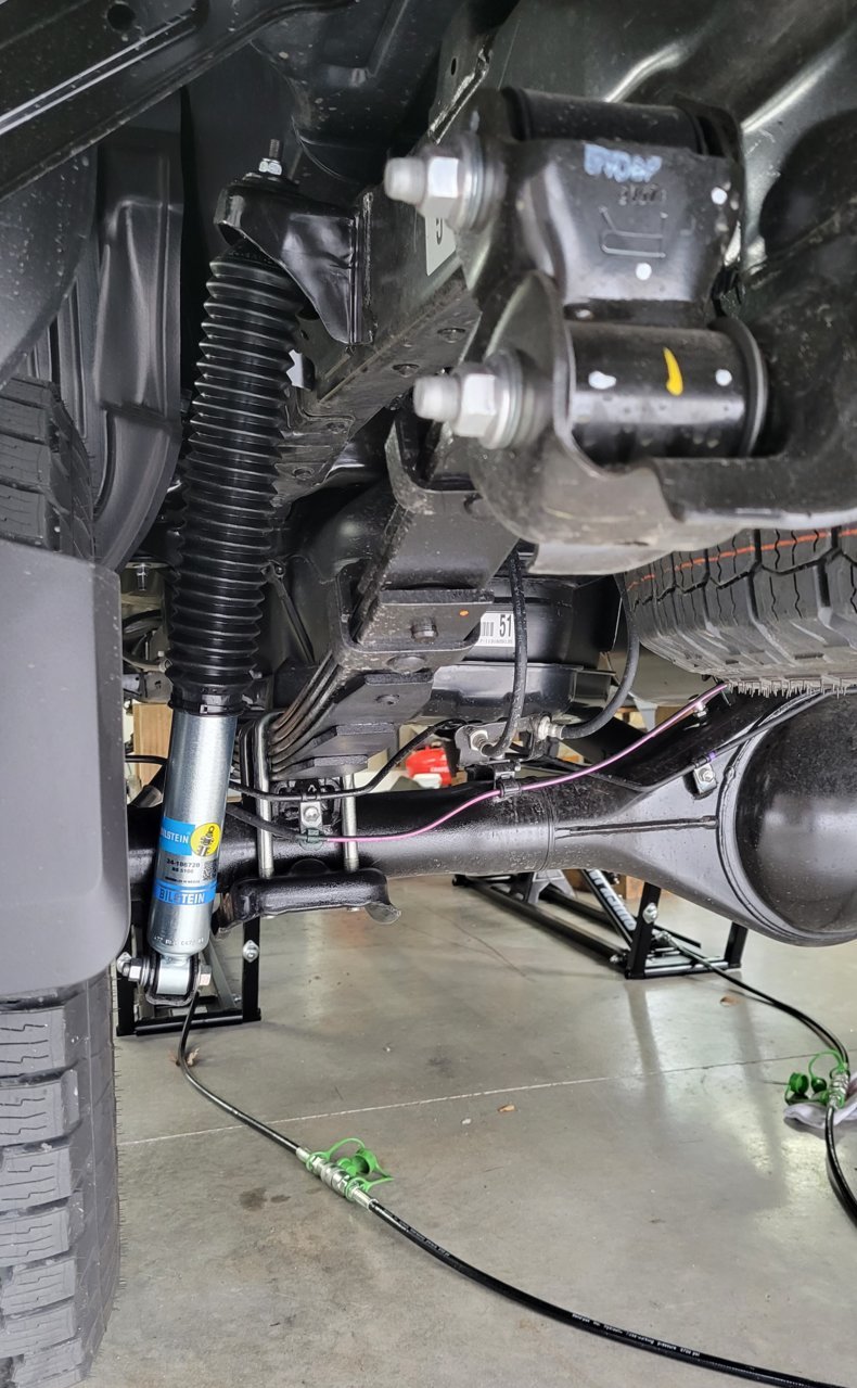

    If that is the case I would go with a Progressive Add-A-Leaf. Pretty good ride when empty and will help you out a lot when you put weight in it. I went with the Headstrong unit and removed the bottom overload factory leaf. . . . . very happy with it. You also don't need the longer u-bolts like they say.

    I 2nd what Gatafly said. I too went with the HS progressive AAL and left the overload off. I used the original U bolts and have 3/8" of threads left on them. My truck rides great even with minimal amount of added weight(bed mat, bed cover and tool bag; 135 lbs total). It's nice to have some arch. The cool thing about the HS progressive is that you don't have to cut off the OEM brackets.... it's a straight bolt on.
    Yes, the Progressive AAL adds about 1.5" lift.
