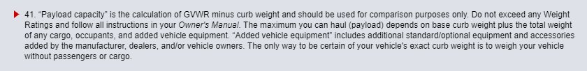

    It depends on your truck options/configuration. 4x2's have higher payload.

    Your weight (and other crap in truck and passengers) + load weight (Tile) = Payload Capacity

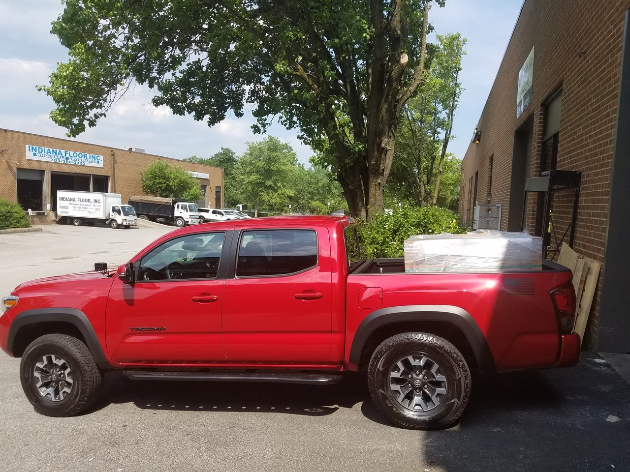

    I had 1500lbs of tile in mine...It handled it fine.

    20170612_153933.jpg Just plan ahead when stopping and take it slow. Also I wouldn't recommend going over 1175lbs if you can avoid it.

    1100 - safety percentage (10% maybe) = weight you can safely carry.
    You may also need to take into consideration GVWR which would only come into play if you have the cab area fully loaded up as well...i think its 5600 lbs on the 3rd gen

    Curbs weight of a OR 4x4 DC would be around 4400 pounds. Official payload capacity is 1175lbs. My Sport 6MT Access is rated for 1275lbs.
