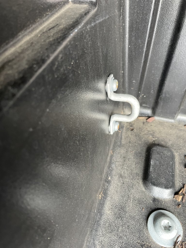

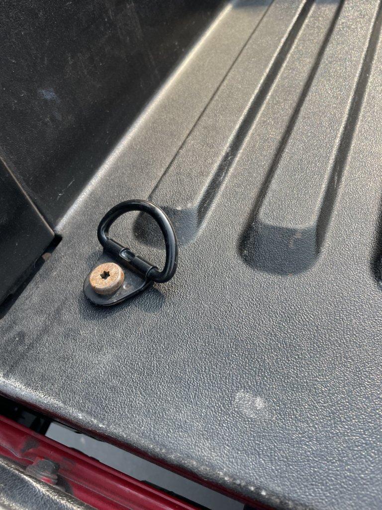

    Get another rear ring remove the front bed bolt put it under that they won't break.

    That’s exactly what I did. I added 6 d-rings to the bed floor today.

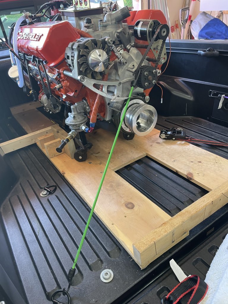

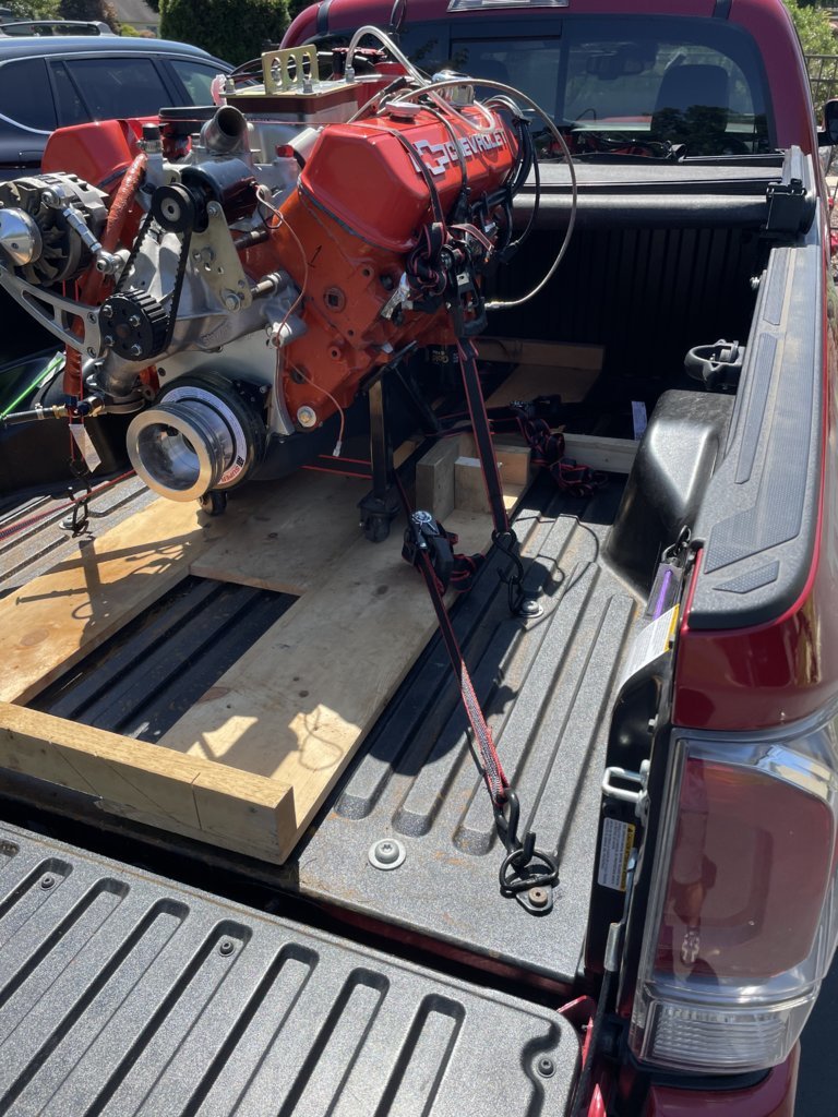

    I would be more worried about payload capacity / squat than that lol. It won't come off don't worry.

    What is on the other end of the belt that the green bungee is hooked to? Usually where the AC compressor goes and a little above a power steering pump but doesn’t look like either.

    That is an electric motor to drive the water pump. For drag racing. Allows me to run the water pump and circulate coolant to the engine when the motor is shut off. Cools it down quickly between rounds.

    That makes sense. Now why does the pcv look like a CPAP machine!

    CPAP machine. :D
    That’s a temporary oil mist separator.
    Don’t want to mess up the AFR readings on the dyno.
