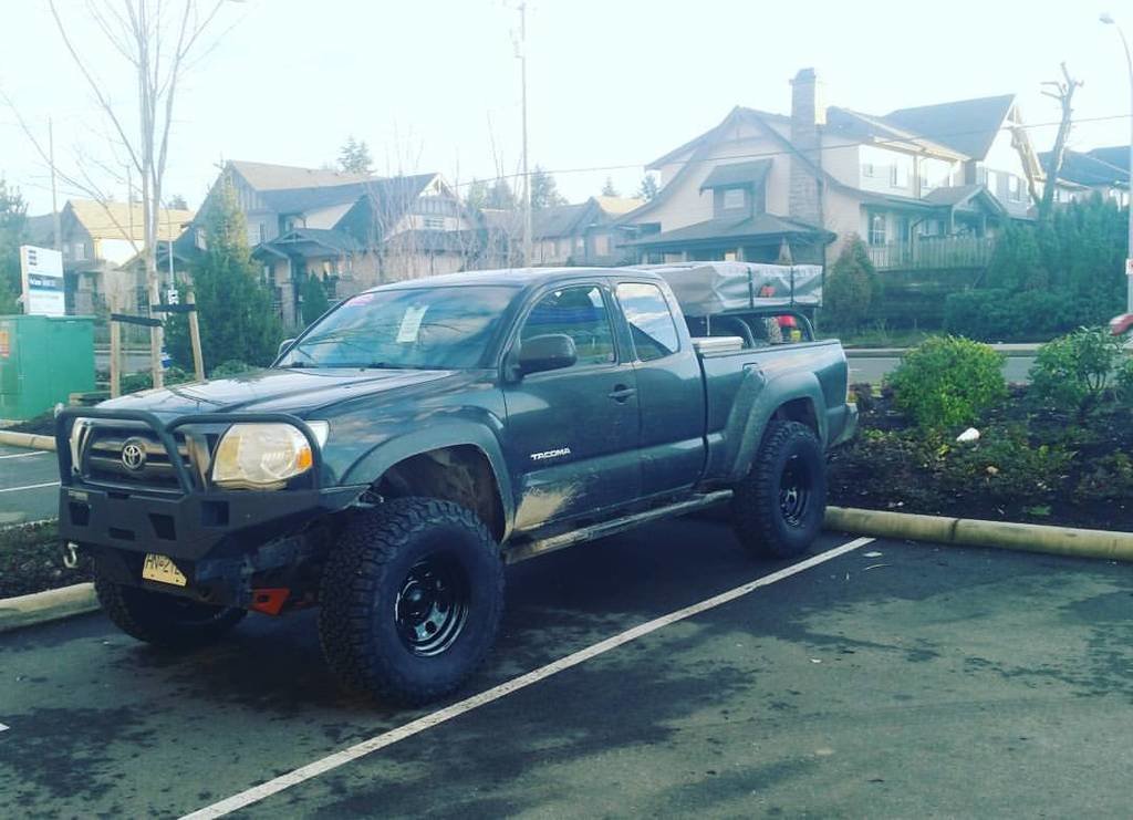

    And ya the 2.7 doesn't care about weight the only time my milage was adversely affected was the week I was running 35's on stock gears
    https3A2F2F41.media.tumblr.com2Fab42e323_d1da5a92a4946aafc74956246c8263e69e34f829.jpg
    22 mpg mixed without the tent
    20 with the tent
    The trick is 5spd if you have a 4cyl auto just give up now
