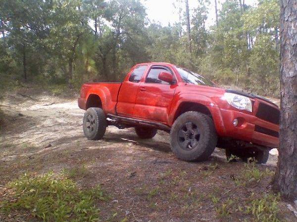

    DIY is not that hard just take your time masking and applying coats.
    My jeep wheels I'm painting.
