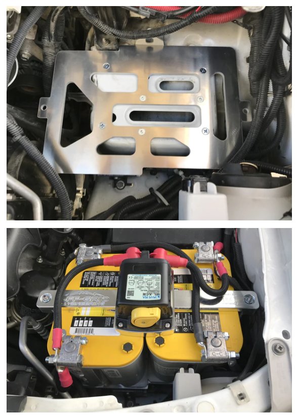

    I have the same problem as I too drive a sport. I am considering off-grid engineering's mounting solution for two Group 35 batteries. I'm not sure what, if any, reinforcing would be necessary leveraging the stock mounting location. You could call the Off-Grid engineering team to see if their customers have had any issues.

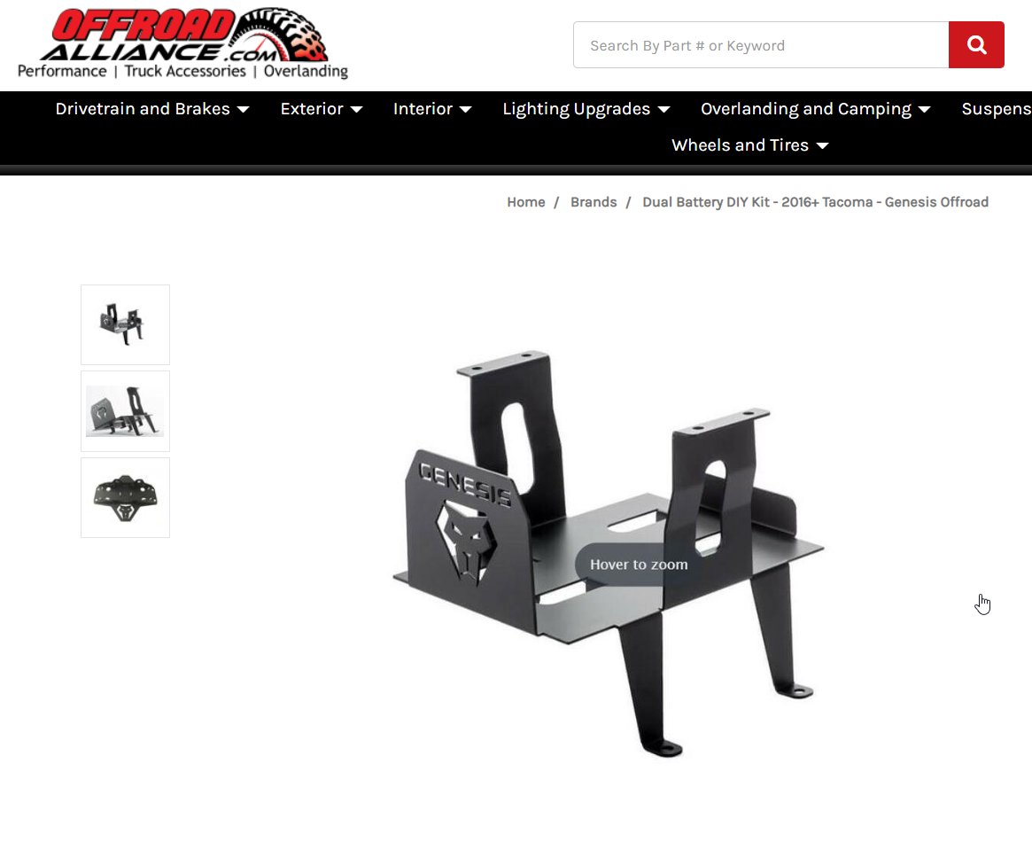

    Genesis Offroad also makes a tray that I like which has additional legs/supports that looks more robust.
