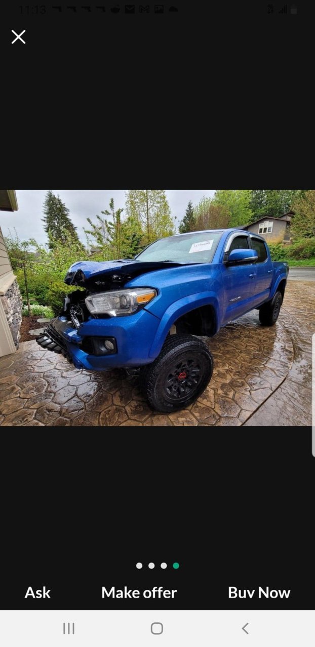

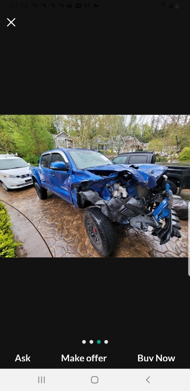

    It was declared a total loss,,,, cause well it’s a total loss, in other words it would cost more to fix than it’s worth.
    With all due respect, if anyone has to ask,,, they are very more than likely not capable of taking on such a project or not in a reasonable timeframe and budget.

    Unless you have a hook up in the collision industry I would pass. Anything can be fixed within reason. I've seen MUCH worse fixed in my days as a collision estimator. But also understand nobody here can give you an even remotely close idea without experience and actually seeing the truck. If you bought this I would take it to a frame shop for an estimate. They could probably also pull the cab. Once it's straight bolting on the rest isn't a huge deal if you know your way around a modern car.

    Start with peeling back the layers and see what you have. You may find it is all in front of the suspension and an easy frame pull. Then again you may find that you really do need a new frame.

    Reserected from the dead.
    On the plus side, that wheel is pretty close to where it's supposed to be.
    That frame may not be as bad as you all think.
    Most of the carnage is sheet metal.
    My last 5 Toyota trucks ( Tacoma's and Tundra's). Were salvage titled auction purchases.
    My present Tacoma was much worse than that. The wheel was stuffed back 7" and the frame was bent pretty bad.
    My frame shop billed me $600. I tipped the frame tech $200. Of course this was 6 years ago. Figure you will pay a grand now.
    Been driving it for 6 years.
    That truck is fixable. It will never be showroom perfect, but it will be payment free. I can look past a lot of imperfections when Im not carting paper on a ride.
    Salvage titled repairable are not for everyone, but they have treated me well the last 20 years.
    If you are at all a bit savvy working on cars, repairables are quite fun.

    Make it look good, but actually far from good, Using chinisium knock offs and counterfit parts, with macco 199 paint. I would say approximately 8 grand. Its not going to be oem.
    Repacing all sheetmetal with oem, all oem parts. 35-45k.

    It’s pretty hard to tell but I have experience in collision repair and that one might not be as bad as it looks. Once you get all that sheet metal and plastic off there I don’t think the structural damage will be to severe. If you zoom in on the driver side your gap between the fender and the door look pretty good this would lend to me thinking the passenger frame rail hasn’t been pushed back much and has very little side sway. The suspension is also fairly close, at least it looks that way from the pictures, and I have pulled them out when they are stuffed clear to the back of the wheel well. The upper rail on the passenger side may or may not be able to be saved. It would need pulled back into the correct position then depending on the damage possibly cut off and a new section welded on. Your a and b pillar’s don’t seem to be damaged. Core support will need replacement. Keep in mind I have no way of really knowing any of this without inspecting and measuring everything out but as far as the frame itself goes I don’t think your in bad shape at all. If you tore everything off yourself that would save a lot of time for the shop. We did some insurance work but the bulk of our work was jobs just like this one. If you found the right shop that does this kind of work you could probably have your structural damage repaired for a couple grand. After that it’s a matter of sourcing all the parts you need to put it back together then body and paint work. A lot of the end cost will depend on how much you can and are willing to do yourself.

    I run a body shop and write estimates all day long. To fix that properly (not going to somewhere where “my friend can do it cheaper” that’s $20k plus all day long. Scrap it and get a new one
