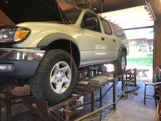

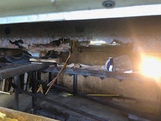

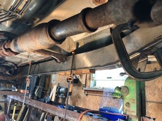

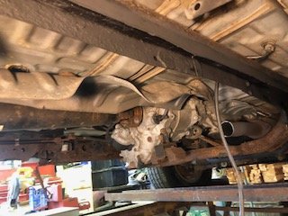

    Nice work! I did same thing on my 2001 DC but also had to repair frame metal under the cab to the front trans mount using the safety frame repair. Big job that may not have been worth if I had to pay someone else told o it.

    can you please talk to me about this set up, it appears to be just what i need to safely get underneath mine on my knees with headroom for mildly dangerous activities
    been at this for more than six months now and this is the first time seeing anything like this!
