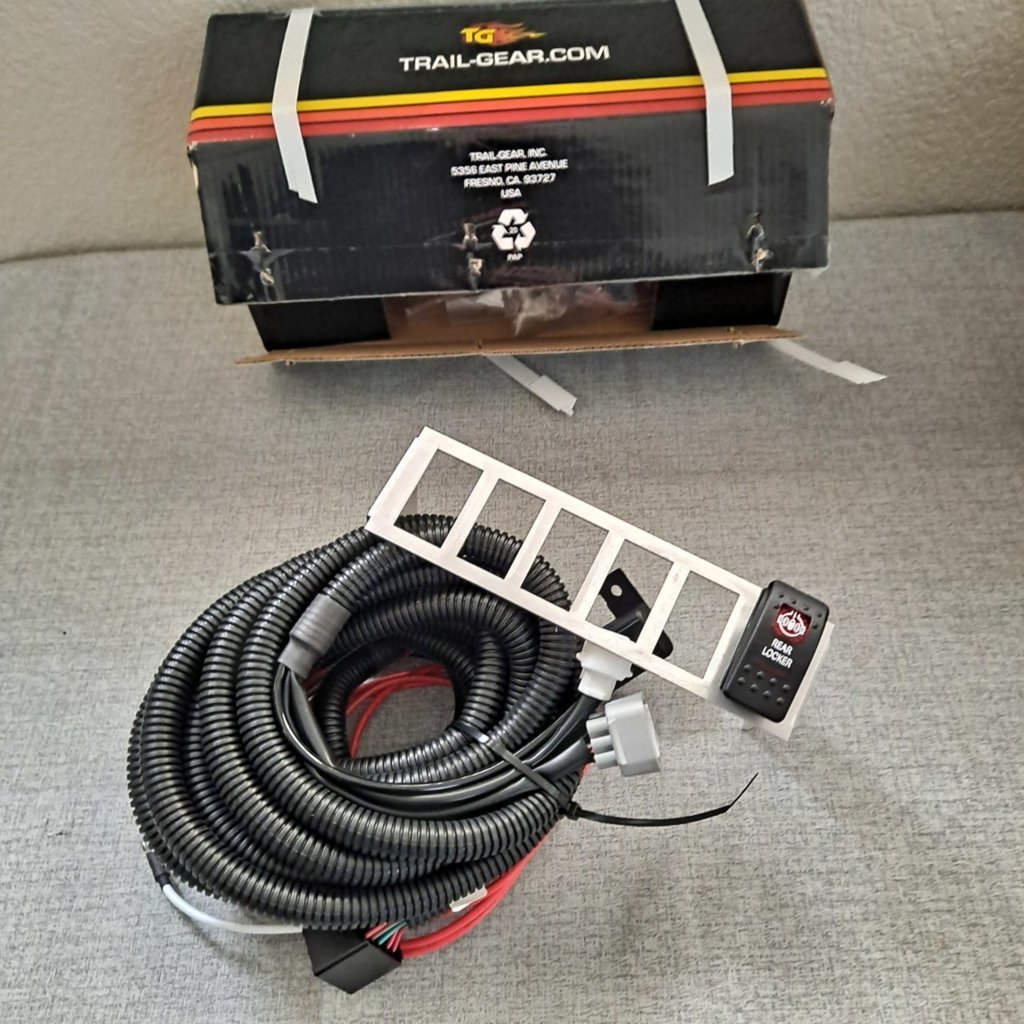

    You can do as I did and pick up a used elocker for 1000 or less and go from there,
    No special tools to install it!
    Use the trail gear plug and play harness and your done.

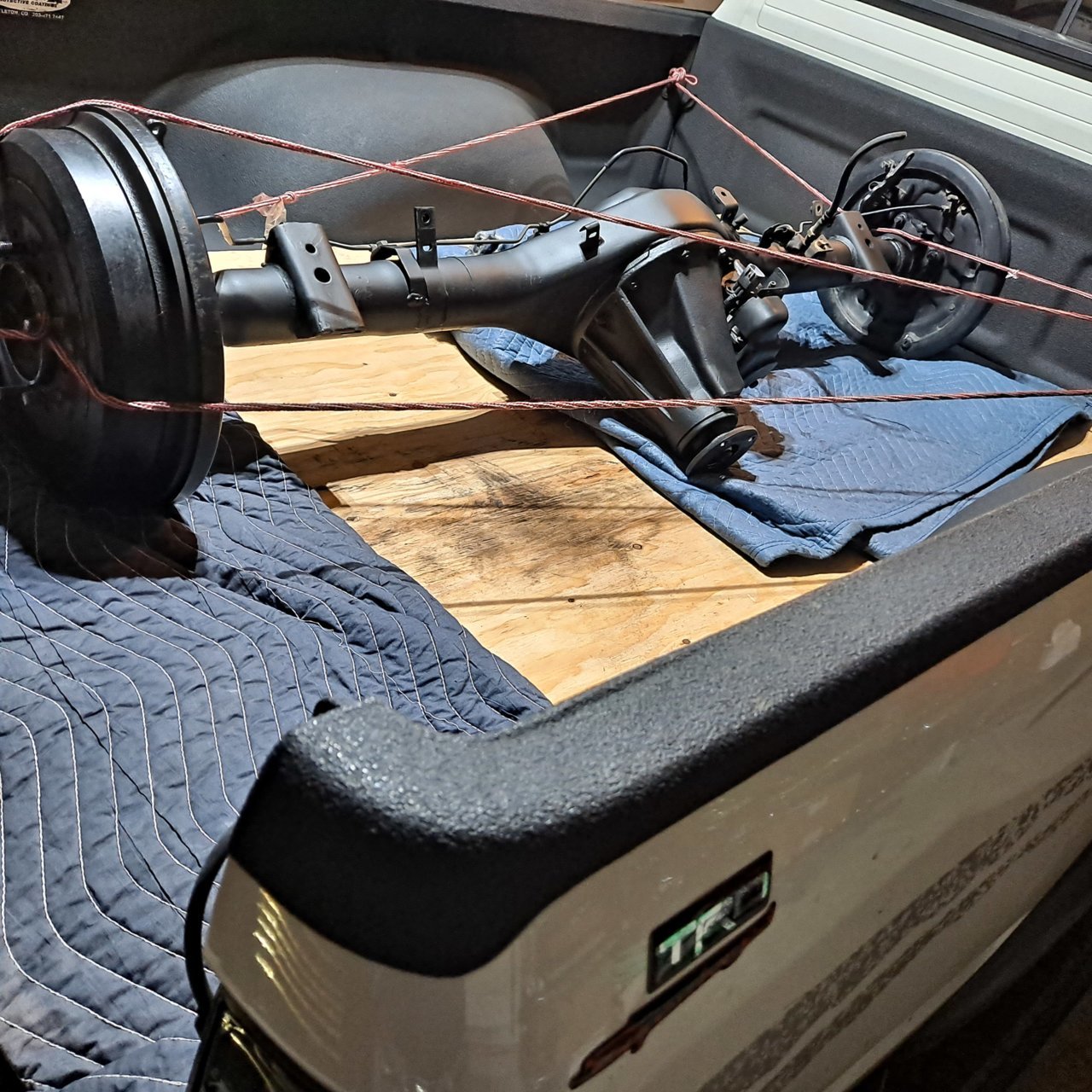

    I actually had a TRD axle that came with the truck, but I ended up selling it and putting the money into maintenance. The 8.4” is supposed to be a little stronger than the TRD 8”, but that probably isn’t a big factor in our light little minitrucks.
    It also had 4.88 gears of unknown origin and a front diff with an LSD to go with it. I wasn’t sure how the front axle and diff would hold up with the gears and LSD either. Probably would’ve been ok but it seemed like overkill.
