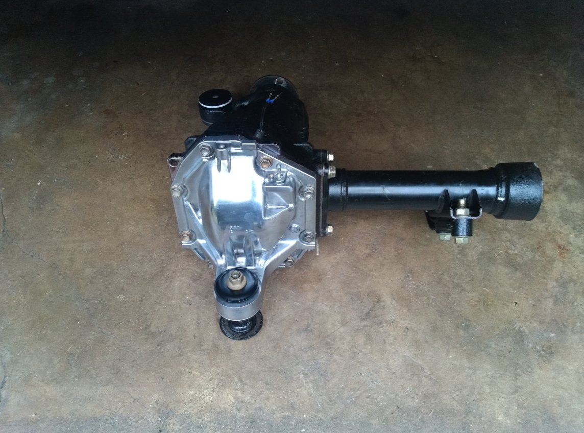

    Your best bet is, as others have said, get a rear axle that has a locker. That's still what I am running in back. (it will be an Eaton E-locker relatively soon).
    I'm IFS... my front is locked with an Eaton E-locker. Best bet is to only use the front locker when I need it. But I'd rather have it and not need it, than need it and not have it. I've used it quite a bit though. The trails I'm on are a lot different than what ya find in Arkansas though :rolleyes:
    Doing the lockers can absolutely be DIY friendly. Have East Coast Gear supply set them up. I've swapped out a rear third member and front clamshell in a day (a couple times now). If you buy a OEM locked axle, the swap wouldn't take much more than half a day to do just that.

    +1 Doing the 3rd member Harrop/Eaton swap on the front was a slam dunk. ECGS would be the ticket. It took longer to polish the diff cover than it did to make the diff swap.
