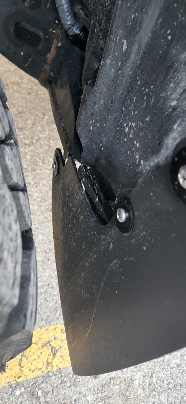

    You can see the rub marks on the flap but not on the cab mount. That a 285/70r17 17x9 +1 had 2 uca set ups bolth with alignments from a very reputable shop.

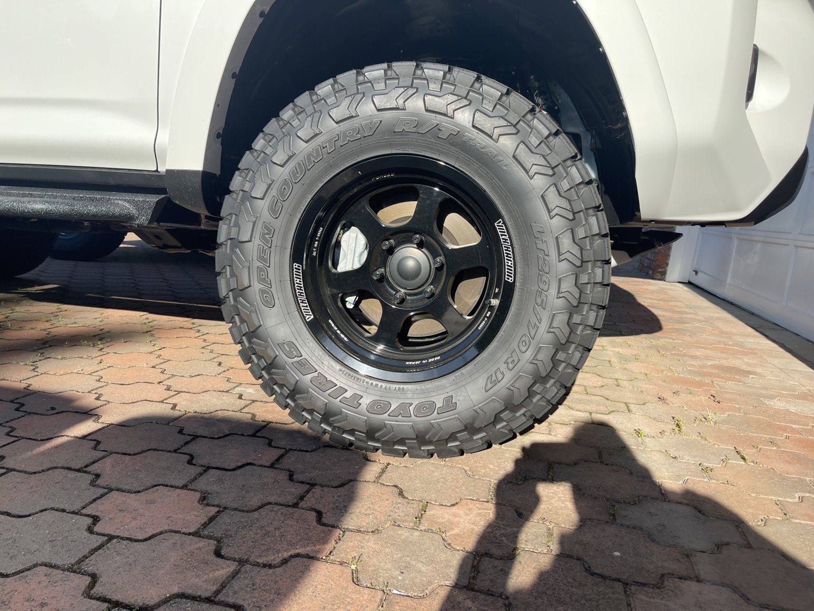

    You might not be tracking this any longer, but I felt a positive handling benefit going from stock Sport wheels to -10.
    A little visualization with the spare installed recently. That offset change could be felt when braking. Haha!

    you can see the lack of clips and rub marks on the front of the liner. I don't have pictures of where it hits the rear of the fender liner. Or the self clearencing that's going on at the fender flare. Point is getting marks like this with the alignment I have state that a 295 or a -10 will not clear a cab mount without a chop. The only way it does is tall lift and don't flex with it turned. But I welcome you to prove me wrong and pull a shock and show it clearing the cab mount full lock and compressed.

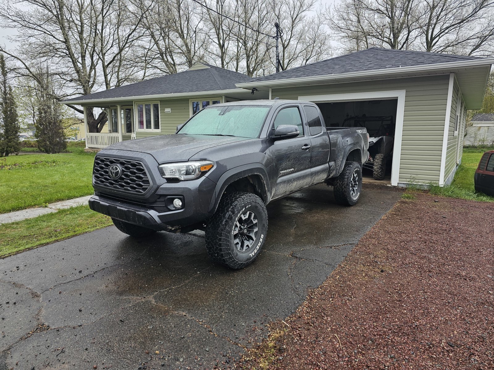

    100% even with alignment with wheels set forward. heres mine with 285s and -25 offset
