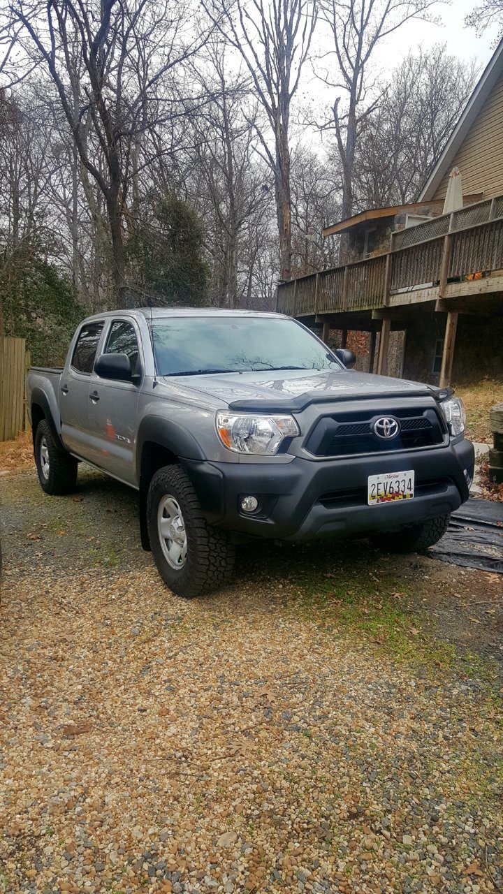

    I recently bought a base 2015 DCSB 4x4. I didn't understand fully about the extras the off-road had aside from shocks and other items that I figured I could add or change about my truck later. I now know (after further digging) about A-trac and a full locking rear. Searching for a new truck after my 1st gen prerunner was crushed by a falling tree.. I couldn't find an OR model in my area with the low miles and price point I got my truck for. Currently, I don't go off roading aside from country roads but I had planned to get more into it once I was able to upgrade my truck a bit more. I know ARB offers a rear locker, I recently bought falken wildpeak AT tires and had planned on putting OME dakars and 5100s on the truck.
    Hearing all the rage about the OR model, I'm feeling a bit left out. How capable is my truck without the locker and A-trac? Any of you wheel the base 4x4?
