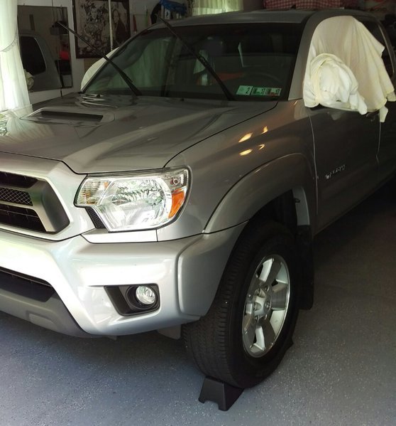

    My Tacoma also sits idle for anywhere between 1 to 3 months out of the year while I am away. My philosophy (not sure if correct or not though haha) has been that it's better for the truck to remain off that to be started every so often just to remain idle.
    Even though the truck is parked outside all year round I do have access to a garage for storage.
    All I do is make sure the tank is completely full with fresh fuel and a liberal amount of stabilizer. Wash the truck inside and out real nice. Lift the wipers and leave the windows slightly cracked. Personally, I also plug the tailpipe and put cloth around my windows for critters.
    My truck is a manual and I like to chock the wheels and leave it in neutral with the handbrake off.
    A trickle charger for the battery would also be a nice idea but I personally haven't used one.

    Looks like his truck is in the garage
