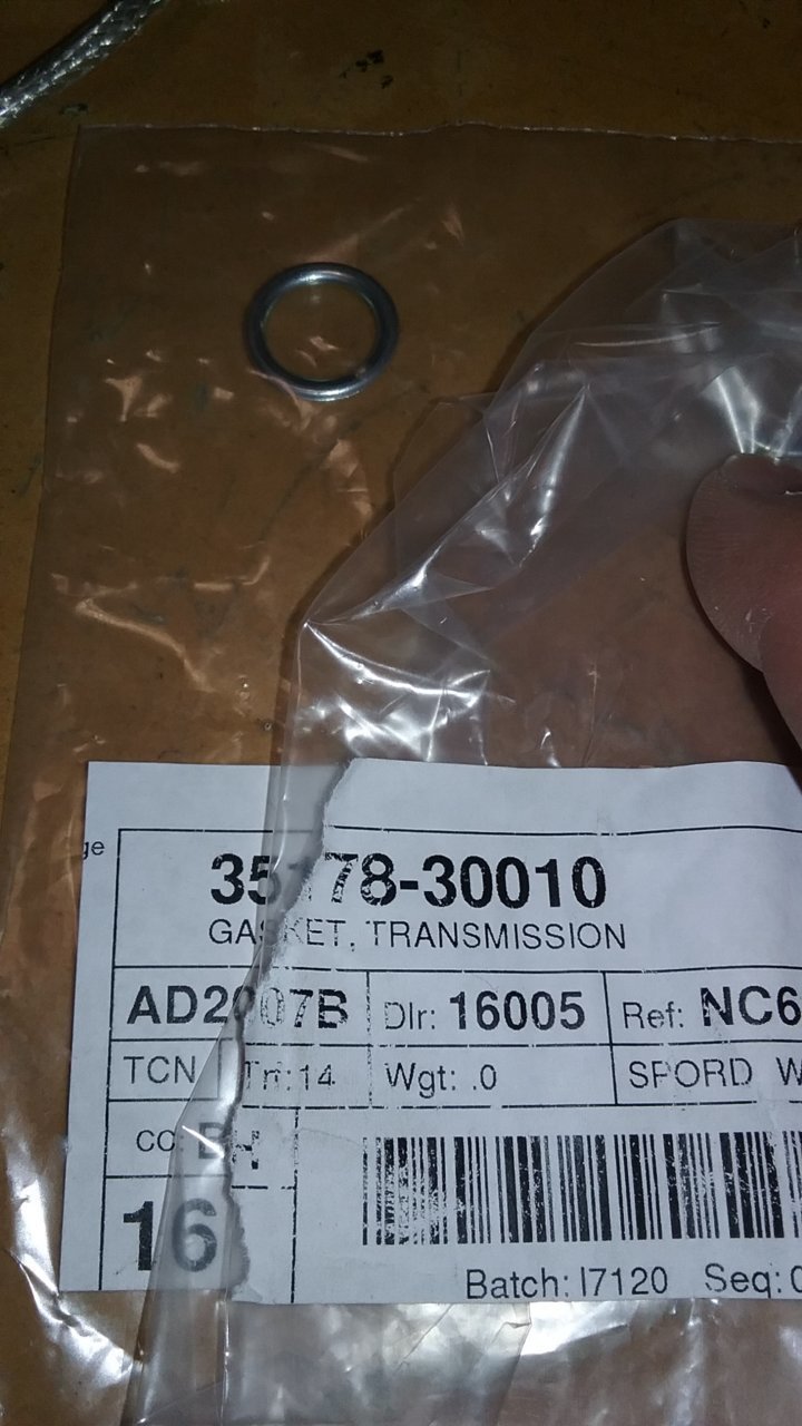

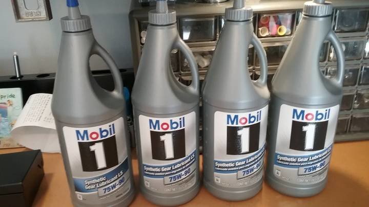

    I think the most important thing is that it's being done at all from time to time....as opposed to never being done. Pick any flavor of 75/90 juice...be it synthetic or conventional and roll with it.
    That said...I tend to be a little more fanatical about maintenance. I do the 30k diff service with M1...which is probably more than needed. But that's me. Advanced Auto stocks it and I snag 4 quarts using a coupon.
    Pick up a couple of these too.
