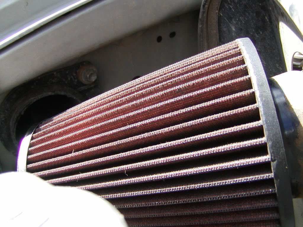

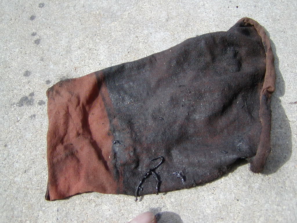

    Granted... I run a pre-filter on my K&N fipk element
    mostly to keep the element's pleats cleaner for the whole weekend off road.
    So basically I pull off the pre-filter sock and shake that out after a days use...
    and the elements pleats will remain clean/ready for another days use.
    One thing recommend for any exposed filter element is to utilize a pre-filter sock
    to keep the element from becoming clogged in between cleanings /or re-oiling.
    Clogging of the filter element can be just as fubar as letting too much pass thru.
    I'm too cheap to pay for K&N's pre-filter sock(boot).
    So instead... I use some women's nylons and cut the foot off.
    This goes over the freshly oiled fipk cone element and works just as good
    but costs way less. (especially if you might have a female mate)
    Yes I lightly oil the pre-filter nylon material a little bit too.
    On the trail... I shake the pre-filter sock out on occasion... re-install and keep on rolling.
    And I'd recommend using a pre-filter on a dry filter element as well.
    I did have a cel come on once because the nylons pre-filter became clogged
    and starved the intakes of air flow.
    But shook out the nylon pre-filter... reset the cel
    and all was good.

    btw... the K&N fipk element shoud not be cleaned just because it looks dirty.
    It actually filters better if left somewhat dirty...
    as that will decrease the element's pleat hole sizing a little bit.
    and oiling the element properly increases filtration even better.
    Yep... there's a reason it sports oil on the pleats.
    In other words... too clean... means reduced filtration.
    Here's some pics of my fipk's pre-filter sock...
    and how dirty that can become...
    and how clean the pleats are inderneath it when it's removed.
