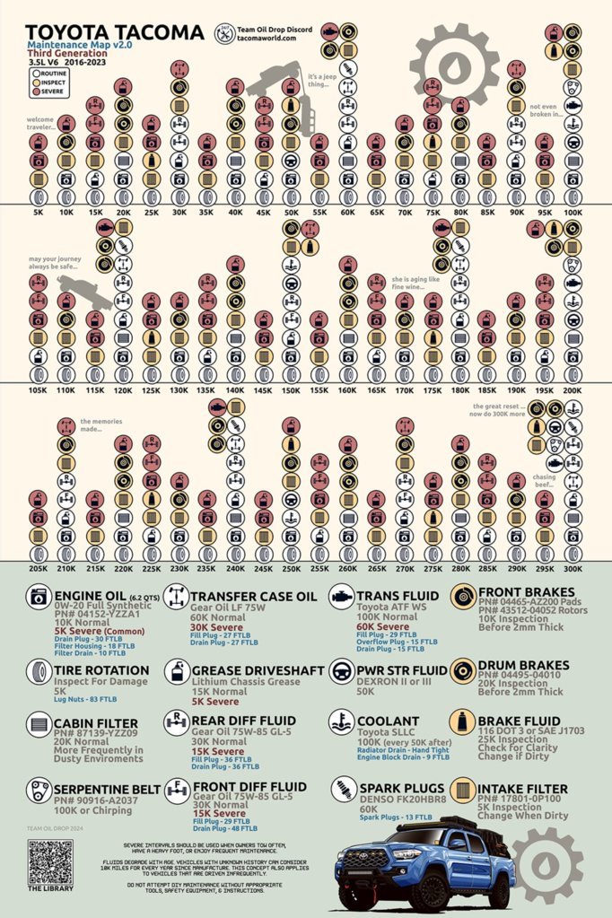

    I’m approaching 50k mile on my 2022 tacoma. Do I change the coolant and power steering fluid at 50k?

    Yes. Along with brake fluid as a minimum

    Coolent? On a 2nd gen it was 10 years or 100K miles.

    Coolant - every 2 years or so.
    PS Fluid - 60K miles, 120K miles, etc.

    For coolant, I don't follow a schedule. I test coolant and replace when it's performance has degraded. Modern coolant lasts a seriously long time!
    For power steering fluid, no set schedule either. I do the turkey baster swap when it starts to turn fugly black.

    Coolant does last a while but it’s also only about $60-70 for a change and not difficult. 50k/5yrs isn’t going to break the bank and coolant becomes acidic as time goes by, it’s cheap insurance especially for head gaskets.
