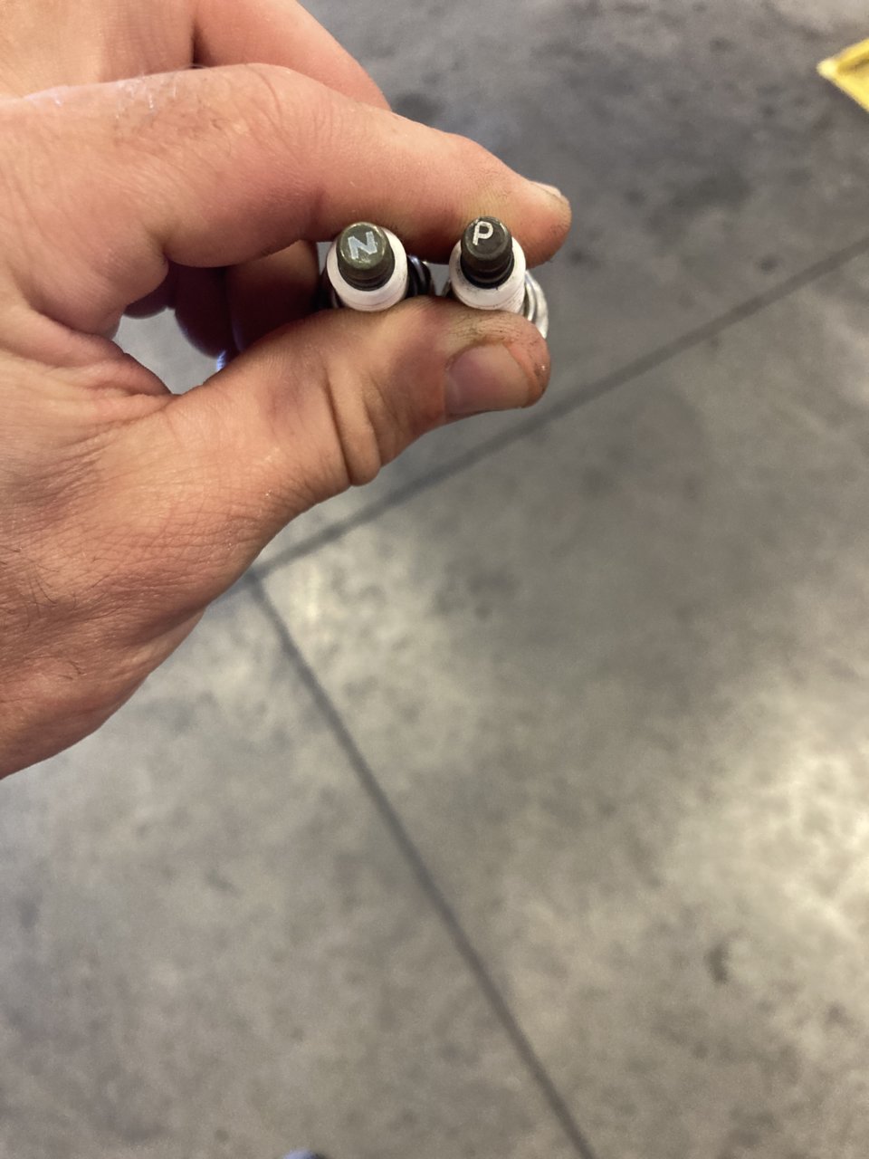

    Pull one plug on the opposite side and if its stamped NGK, then you know that the original plugs have never been changed.

    FSM gap is about .040". In my 2nd gen, the gaps were about .060" after 31K. Hard to tell by just the photo. Was this plug from the driver or passenger side?
    Denso Iridium Long Life plugs will let you increase the change interval from 30K to 100K, so it's great if you're lazy and don't want to spend more effort on maintenance than you have to. I did exactly that and didn't have any problems.

    At the other end of the spark plug, sometimes there’s a stamping on it. If there is… they be original. May look something like this. Also buy oem plugs as others stated

    Passenger side is Denso from the factory, so your plugs were changed at least once.
