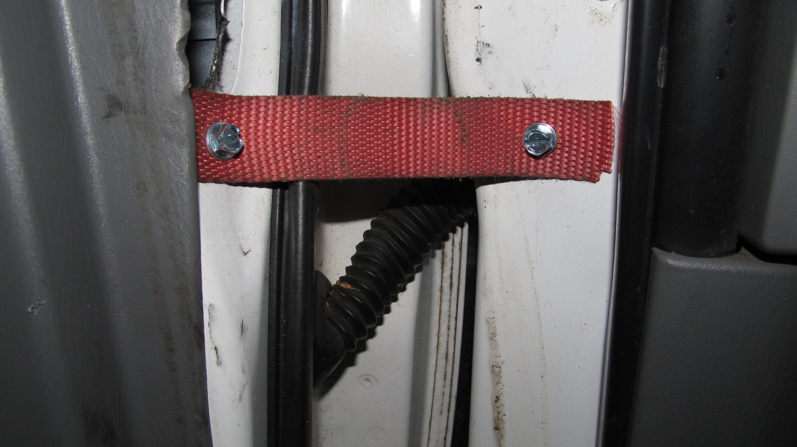

    Not sure what the part is called, but there is a small piece on the doors that limits how far the door will open to prevent damage to the hinges. That broke on the driver's door recently. I replaced it with a 5" section of nylon webbing I cut from a ratchet strap. That's how Jeep has been doing it for years.

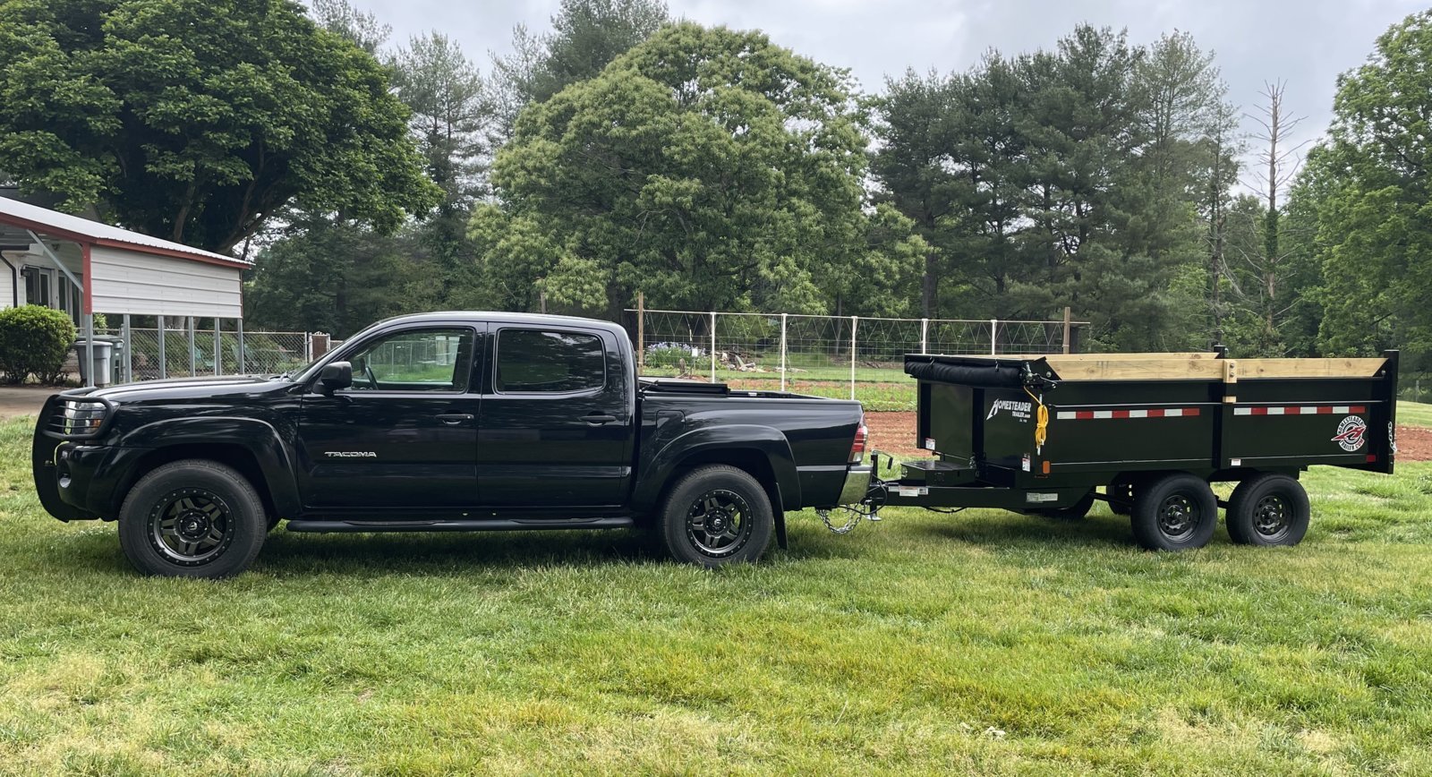

    I've got a 2011 SR5 4x4 DCSB, 137K, which I think is low mileage for the age. Runs like a Swiss watch, no rust, a couple of scratches in the finish (black), interior perfect. It's my daily driver and work truck and tows quite a bit near its rated limit (factory tow pkg). All I've done to it is a set of 17x8 wheels and it had a nice front brush guard on it when I got it. It had 60K on it when I bought it in 2017 from a Toyota dealer. Not knowing what the dealer did to refresh anything., I started worrying about stuff like trans fluid and diff/transfer case fluids at about 115K. Changed all that and the old stuff was dark but not terrible. No leaks from anywhere, and the oil level drops maybe a pint between 5K oil changes. The old plugs indicate no abnormal oil burn. I use Valvoline full syn and Toyota OEM filters, and Toyota trans fluid and Redline diff and transfer case lube.

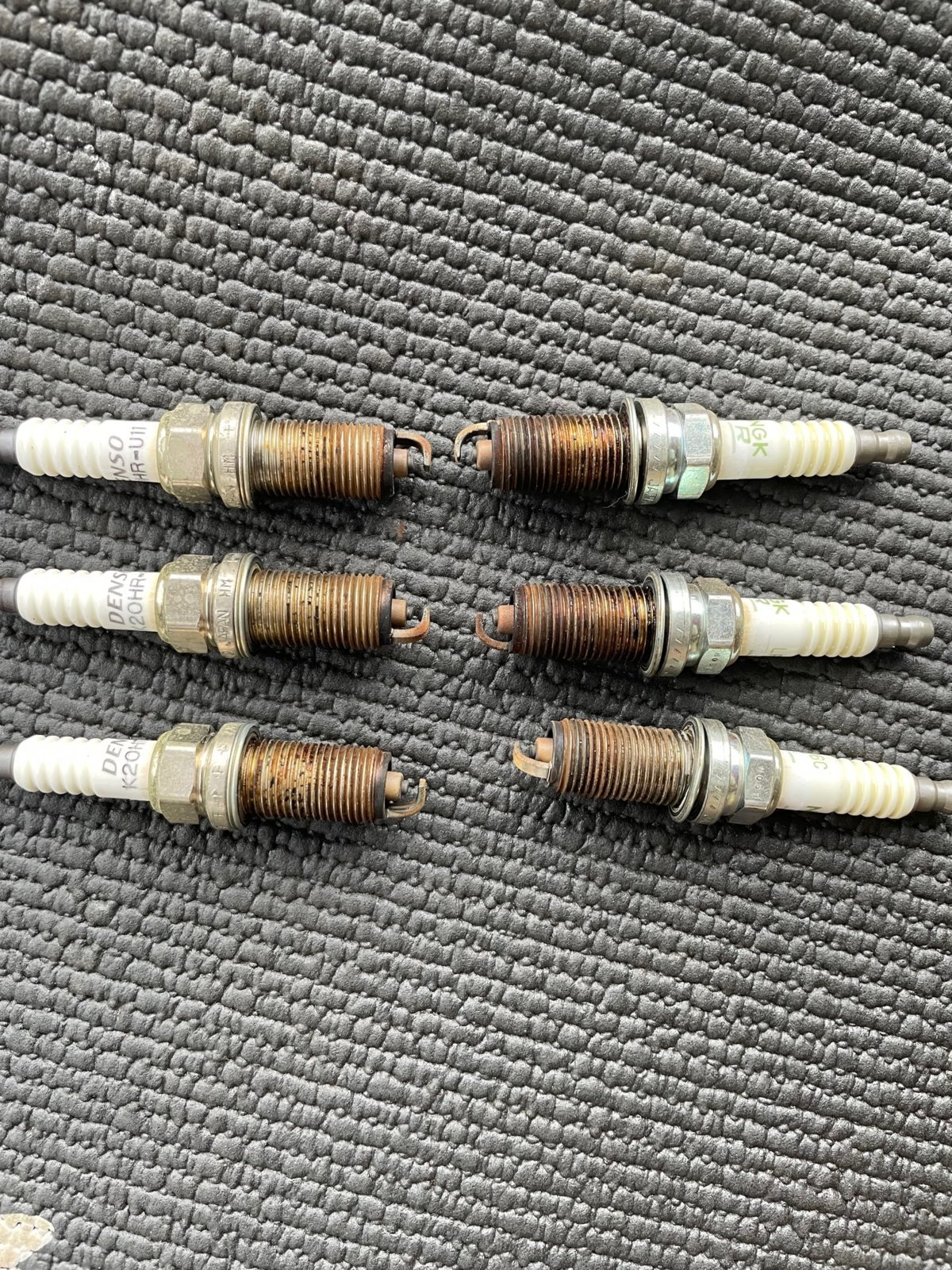

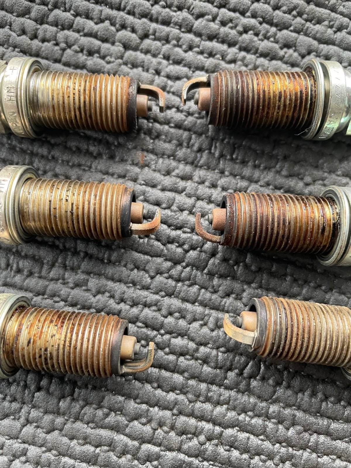

    This week, I decided to change the spark plugs, and figuring mine was old enough, it didn't come with iridium, so I decided to put that type in (Denso OEM). I was surprised to figure out the plugs had been changed at some point, but?????? when I removed the old ones, the driver side bank were all NGK, the passenger side were Denso. They were all the same color, a nice light tan, electrodes worn worse on the NGK than the Denso, but they were non-Iridium like I figured. The truck still started and ran fine, no misses, but I swear it was like snot on a doorknob smooth after the plug change. Watching my mileage for a while to see if it improves any, I don't expect it too, really.

    No, the 4.0L came that way from the factory, with NGK on the driver side & Denso opposite. I think the explanation I've heard for it is that the drivers side plugs are a lot harder to access, so Toyota put longer-life plugs on that side to give a longer maintenance interval? (Not sure if my memory is serving me here on the why, but the fact that the plugs are different each side, from the factory, is well-documented elsewhere)

    If that's the case, then the plugs I pulled were the originals most likely. You saw the pics; not terrible shape, but definite erosion on both center and ground electrodes. I figured they would look worse than that at 137K miles, especially being a standard type plug and not a platinum or iridium plug. I was very satisfied, though that the plugs showed no evidence of anything abnormal in the combustion processes between cylinders. Happy to know I have a healthy engine.
    The driver side plugs are a PITA to change; but I didn't feel it would warrant installing longer-life plugs. Pull some vacuum lines, remove two airbox/intake manifold supports and unclip a sensor pigtail. Using a long 3/8 ratchet extension taped to a spark plug socket with a ball-joint to a short extension and it was fairly easy. reconnect the lines, pigtail and replace the braces. The coil leads were no problem to disconnect, but it did take twice as long to do the driver side as it did the passenger side. Just had to remove the air horn and filter compartment to access the right side. All told, an hour and a few minutes for the whole thing and not hurrying. I wanted to make sure I loosened the plugs gradually so not to gall the aluminum threads on the cylinder heads, and the new plugs threaded in with fingers twisting the socket extensions. I did not use any thread grease. Last time I changed a set of spark plugs has been about 7-8 years ago when I had my Miata. They were a piece of cake. No coil-on-plug, just pull the wires and unscrew, reinsert and tighten, replace the wires. 4 plugs in about 15 minutes. Wouldn't have taken that long but you had to gap the plugs first.

    As per another/previous poster: the "three Denso"/three NGK" being an indication the plugs are the original OEM's installed at the factory. Another "tell-tale" that the plugs are original is a number stamped on the metal tip above the insulator: Any installed OEM replacements will not.

    Some have issues running iridium plugs.
    Recommended interval is 30k miles so yeah they’re due for replacement. They look pretty good considering 167k miles.
