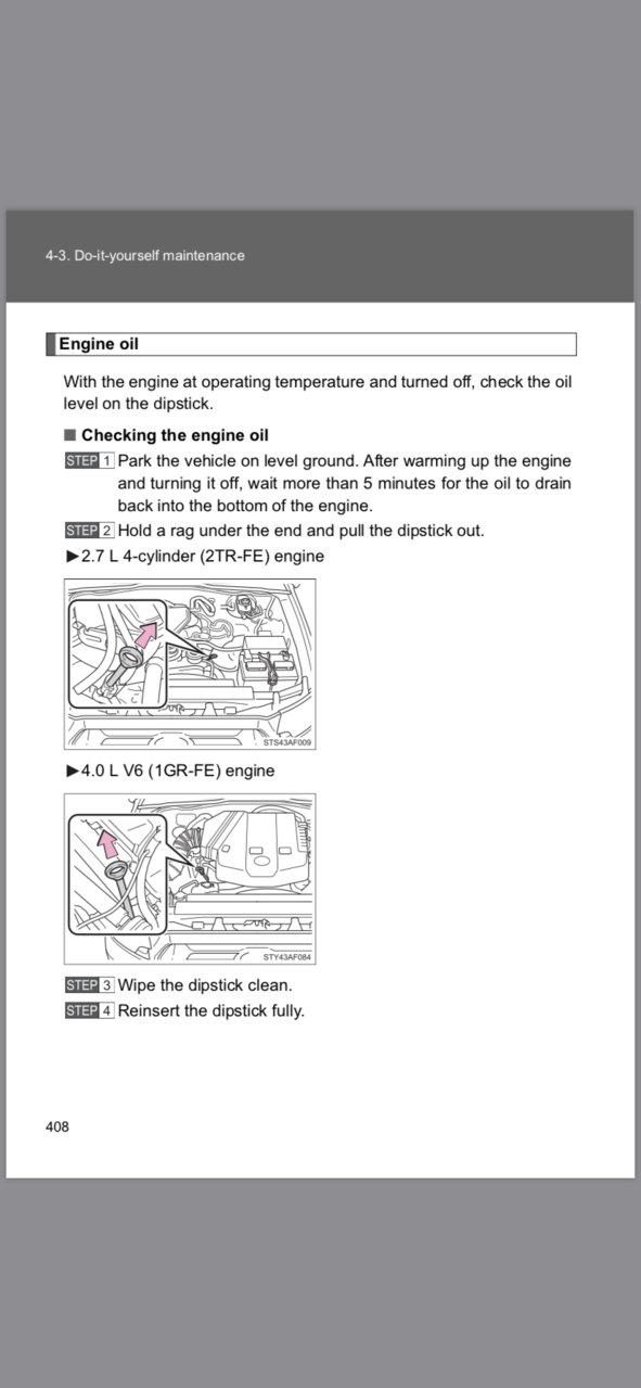

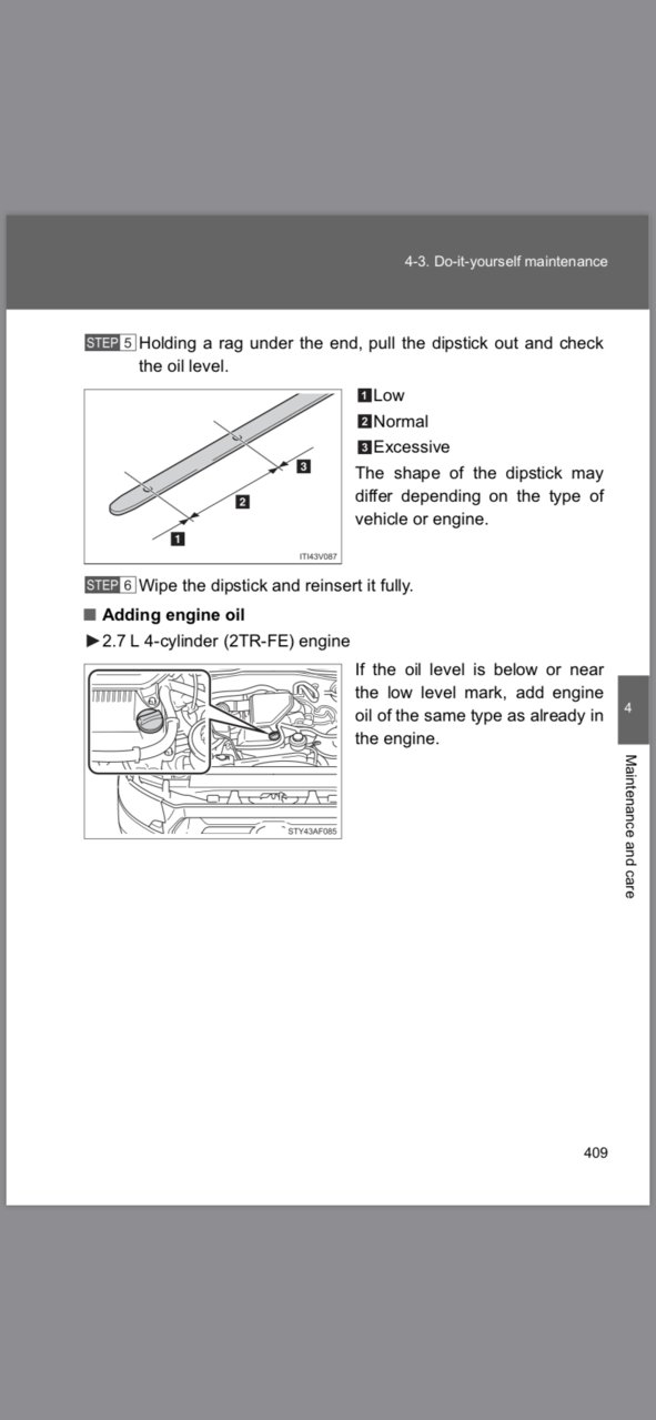

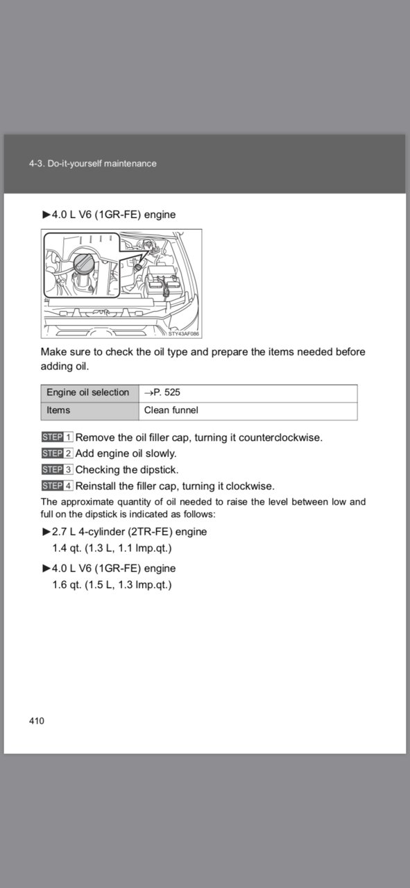

    See the very first line below.
    Operating temp is most likely a recommendation from all manufacturers.
    Remember, according to the manual, anywhere between the marks is normal, only add when you get to or below the bottom mark. If you’re at the bottom mark, add one quart and you’re good to go
    2FEB363B-1161-44E2-B5B6-81D34CFF651A.jpg 58D6FDBC-6AFF-4261-A6FC-170C33308382.jpg BC12112D-206A-4F82-8299-8C627DB25431.jpg

    Where can I get or purchase this book you all post photos from?
