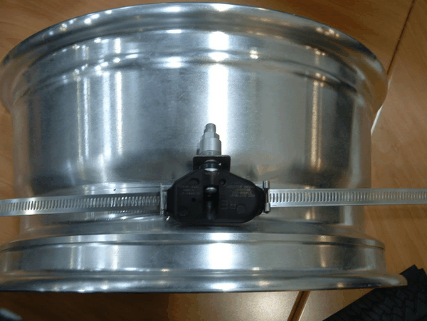

    Been running a TPMS strap kit for 55,000 miles with no issues. Multiple mounts and dismounts of tires.

    It holds the tpms sensor to the wheel in this fashion:
