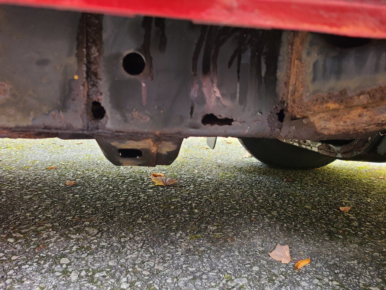

    Hey all. I have a 2010 Tacoma and have some holes in the frame. It's passed the warranty, so no help from Toyota. How screwed am I with this?

    Pretty screwed. Where do you live? Do they use salt on the roads?

    If your State allows it, see what a GOOD welding shop with FRAME EXPERIENCE say about it. There are sites that sell repair sections for truck frames.

    looks worse than mine that I am replacing the frame on

    They most likely denied a frame replacement based on the fact that his truck is past the "12 years from first in-service date" stipulation rather than the size of the hole.

    Yeah, tell me about it. I probably should have been more vigilant or checked more deeply. I have a work truck so this isn't my DD anymore. I'll have to clean it up and see what I'm up against I suppose.

    Not to be the barer of bad news.
    But that’s BAD. Real bad.
    They rust from the inside out too.
    Take a small ball peen hammer and start hammering.
    Seriously, that’s really how you tell “how bad” it is.

    You are the proud owner of a 2010 parts truck unfortunately.
