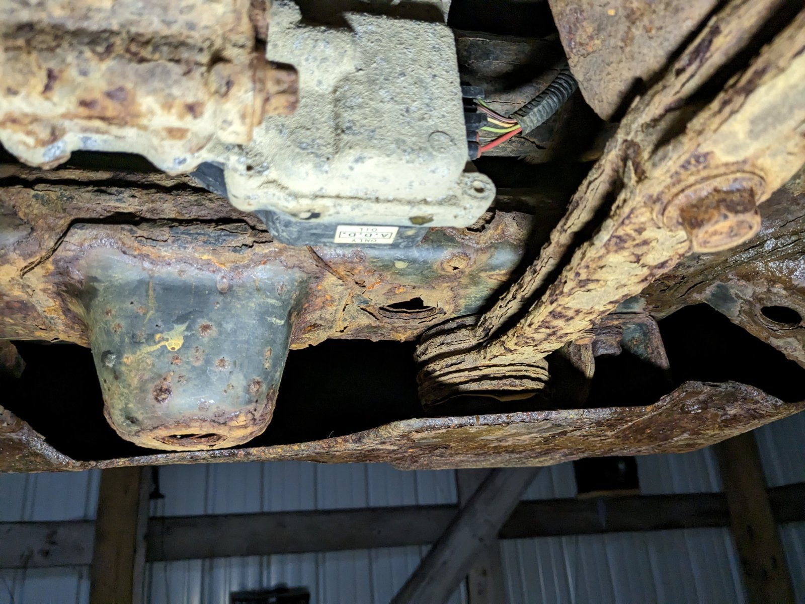

    Well, an update for any interested. I took my truck to an authorized installer from autorust.com and they repaired the frame for 1600 bucks. They cut out the bad stuff and welded in the new stuff. The rest of the frame is solid and I plan on getting a needler to clean the rest up.

    Wow they did a great job on it!! Good stuff!

    That's a helluva save right there, congrats!

    That turned out amazing! Nice save even though it cost a bit of money. Better than a frame replacement.

    $1,600 bucks? A bargain at twice the price!

    Fluid film every year and you'll probably never have another issue.
    $1600 well spent.
