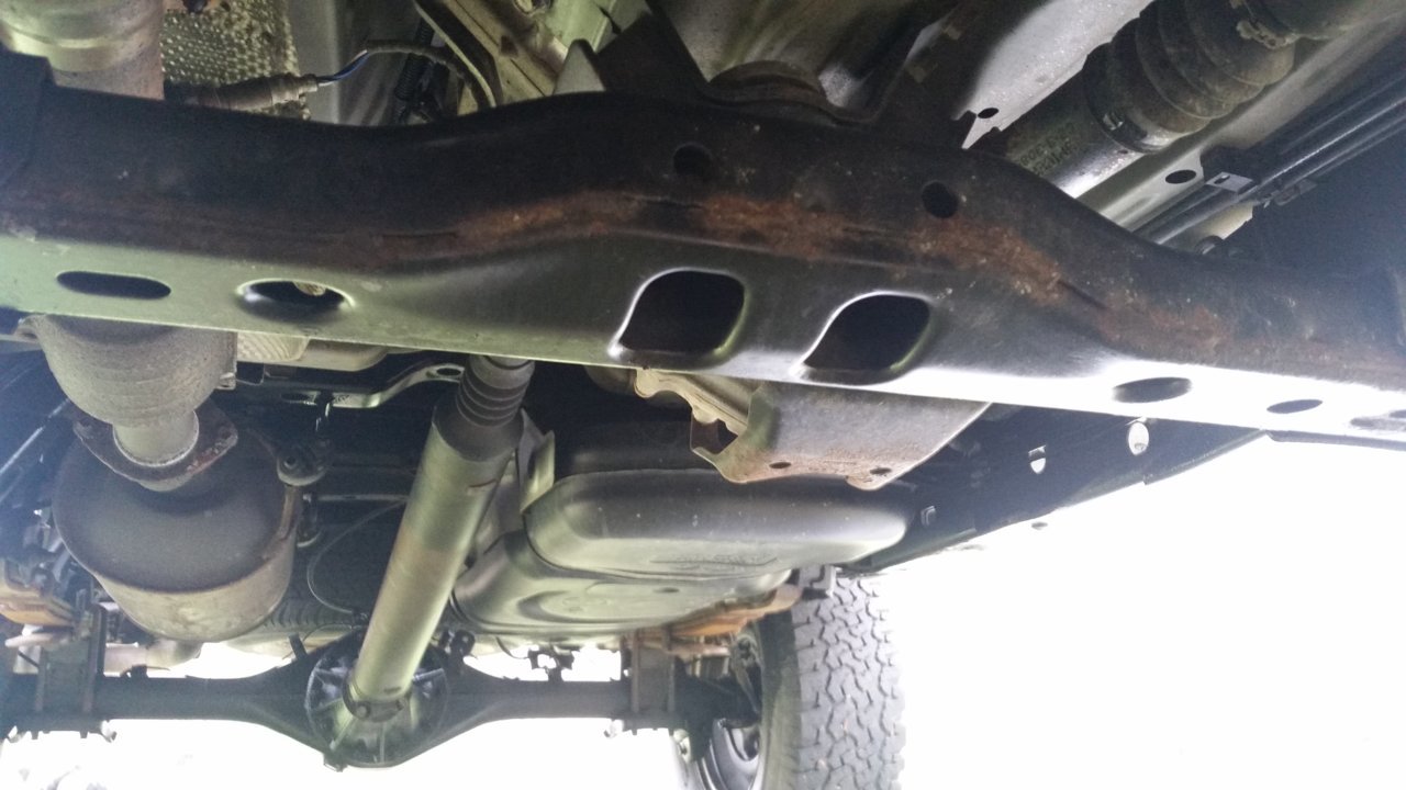

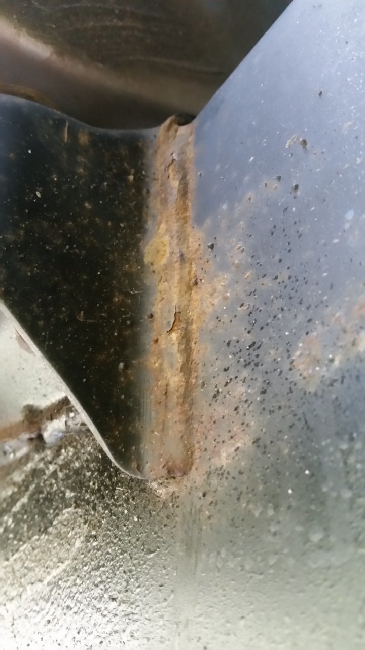

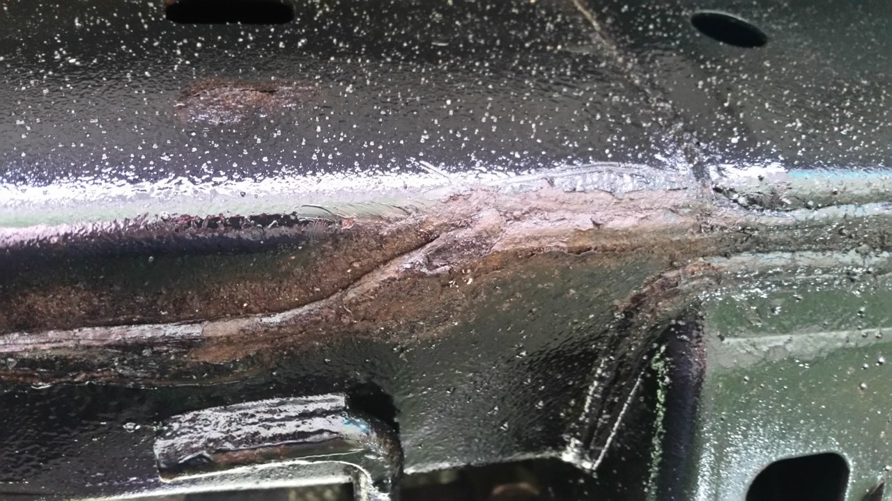

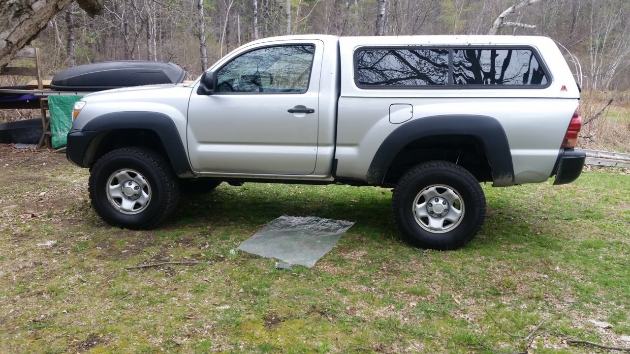

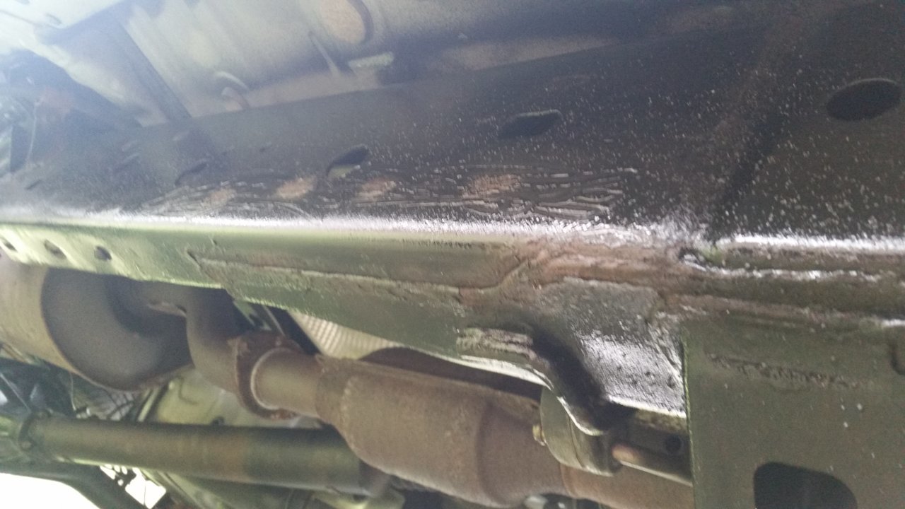

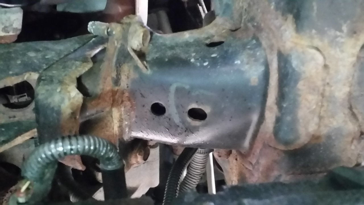

    Hey everyone. So I bought a 2012 recently as was in a bind for vehicle and didnt notice the black rubber undercoating was covering up rust until now. Theres surface rust on wields, bubbling on frame, and spots where paint flakes off with rust.
    I have health issues and need a reliable ride to the hospital but I think I got a rotten deal and have to think of selling it. 140,000 miles and was $13,000. I'm in New England and its hard to find anything clean. I was wondering what you Tacoma enthusiasts thoughts were, here are some images.

    That is fairly minor rust for New England. Price is about right considering what these trucks go for. Don’t sweat it and plan on fluid film in the fall or sooner.

    That’s not bad at all. Rust on the welds is not rusting through. Strength will be there for years to come. Drive it!

    Agreed. That's pretty clean for a 10 year old truck in the salt belt.

    That's not bad at all. That truck will probably give you many years of faithful and reliable service.
    That said, take the truck to your local Toyota dealership and have them inspect the frame. This will qualify you for a 12 year (from the first in-service date) frame warranty. Trust me, you want to do this to protect you from future rust. Oh, and it's free!

    I'm not in the rust belt, so this is outta my wheelhouse. Is the sprayed on protectant wearing off or applied poorly? Seems like the parts you can't see unless you crawl under on your back, or parts that are harder to spray are not sprayed except for some overspray from doing the side of the frame rail.

    Based on what I see in the pictures, your frame will pass the inspection. If it does, they will still want to do the latest "inside the box section clean, dry, de-scale and coat" process to extend the life of those critical areas. As others have said, Fluid Film, Wool Wax or a number of other products will extend the life of the outside of the frame. Trust me, that truck will last a long, long time.

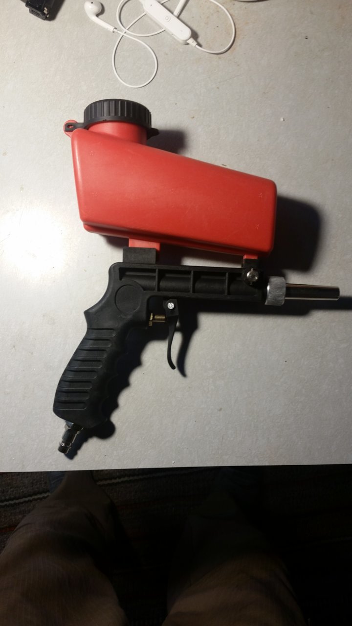

    Say hello to my little friend... Load er up with some baking soda and go to town.
