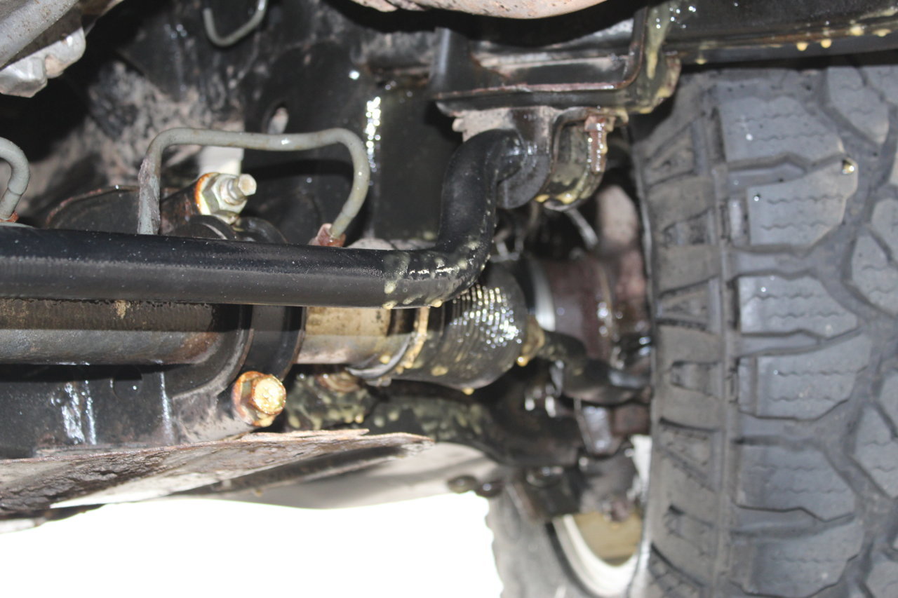

    If they won’t take it back, would asking them to clean up the undercarriage at their service department be too much to ask?

    It does not need to be north to get rusted like that. Very possible it was "driving on a beach" truck. Ocean water will do the same as stuff they put on the road up north.
    On one of those pictures it looks like your dealer did a hammer test on the frame, so probably it is not as bad as it looks. It looks like this truck was coated by Toyota's recall campaign (which we know did not do anything good to prevent the frame from rusting), either the coating was put over the already lightly rusted frame or it is now flaking off revealing the layer of rust under it. If you are going to keep this truck I'd recommend to clean that frame from the coating and rust and paint it properly with rust-eating paint. It's a lot of work but better to deal with surface rust now, than rotted frame later. All other rusted parts, bolts, shields, e.t.c. you will have to deal with them when the time comes for maintenance or repair. Be ready for the fact, that most of those bolts will break when you try to undo them.

    Either you had the dealer put the truck on a lift for your in-person inspection, you left the dealership with a soaking wet back and some drained batteries in your flashlight, or you didn't do your due diligence. You didn't get scammed -- you just didn't pay attention to what you were buying.
    Rule #1 is never test drive a vehicle in the rain because it masks squeaks and rattles. Using "dark and wet" as a reason not to crawl around under an 18 year old vehicle, especially for that purchase price, is just asking for trouble.
    I'd be truly surprised if the selling dealer does anything for you. Your best bet would be to buy some tools and turn some wrenches. Most of what's looking ratty is bolt-on stuff that would likely need to be replaced on any vehicle of that age.

    When I see such suggestions I'm always wandering: "sell it" to whom? Even if the new owner buys it cheap (loss is taken) he still will have to "Messing with that damage will only cost more and more and aggravate (piss you off) every step of the way....for years.". So you are saying that dealing with all that $hit is OK if you play less? In that case why bother selling it - take the loss (like you would sell it) and deal with all that mess yourself.
    This truck is not done yet, with some patience, money and skills it can come back to glory (if engine and driveline is fine). Of course if you can get any help from the selling dealer (I doubt - they already spent that Christmas bonus) it will be better. I don't think they are at any fault - they did not cover up the rust or the condition of the truck. It was sold "as is" and "as is" was clearly visible (with look at it with flash light). One positive thing is that average blue book value went up in Florida when this selling price was registered :D

    Yes, you overpaid based on condition. What is important now is to determine if the truck frame is salvageable. I would take it to an independent shop and have it fully inspected as mentioned above and get a report. If the frame needs to be replaced, I would take it back to the dealer and see what they can do for you.

    doesn't look all that bad. most vehicles of that age up by me are the same or worse. frame looks like it was coated by toyota a few years ago and is starting to flake off.
    as long as the frame is solid, everything else can be replaced fairly easily. just need extra elbow grease and to expect some broken/stripped nuts and bolts working on the rusty ones. check the brake lines, replace any necessary parts, and then run the truck. no big deal.

    in fact, if you replace the gas tank skid and those brake shields and take the same photos again, it would look pretty decent under there. you can get those parts from a junk yard (or an "online" junk yard parts website) for pretty cheap

    It's funny -- the more I look at the pics the better the truck looks. Replace some bolt-ons, powerwash everything, apply a coat of fluid undercoating every year or so and this thing will be a solid, long-lasting truck.

    salesguy lied to you
    that carFax shows this was a PA truck for a really long time
    moved from Ohio to Florida a couple years ago
