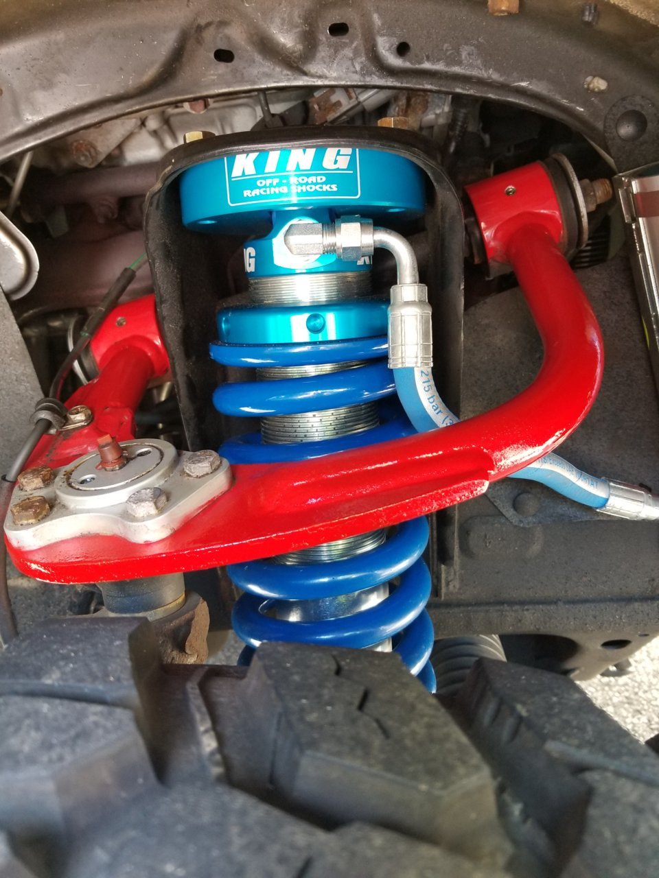

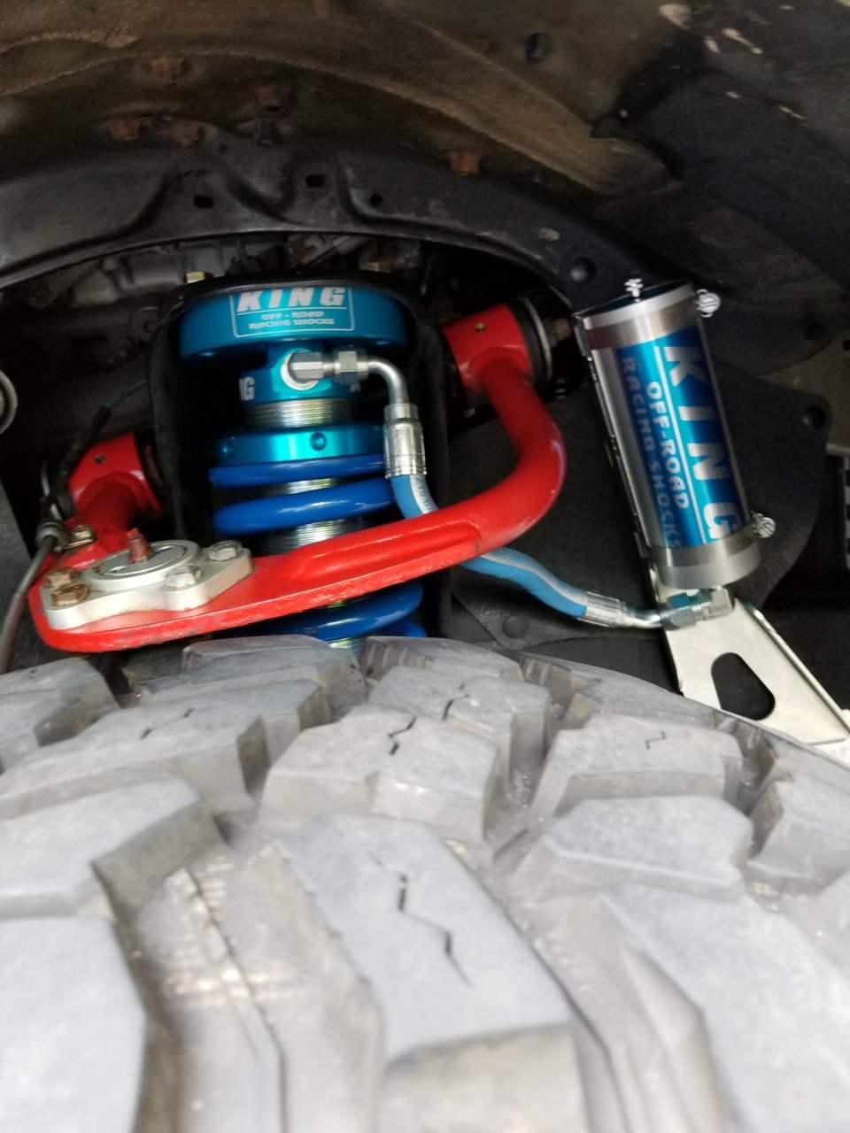

    Better than OEM ride

    I would suggest OME or 5100s with new coils to whatever lift you want to keep a good ride. 5100s do not ride terrible set at 1.75, going to be a little stiffer but not bad. Or you can get the kings like above and be able to post pics of them all the time. But seriously cheapest route is 5100s.

    Don’t mind the asshats that tell you to get kings.
