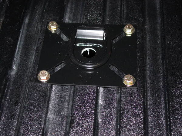

    Bolt it to the bed bolts that go to the frame. Any winch will pull apart the fiberglass bed and/or rail mounts.
    Or do something like this bolted to the floor of the bed which would be way better than bolting it to the sides.
