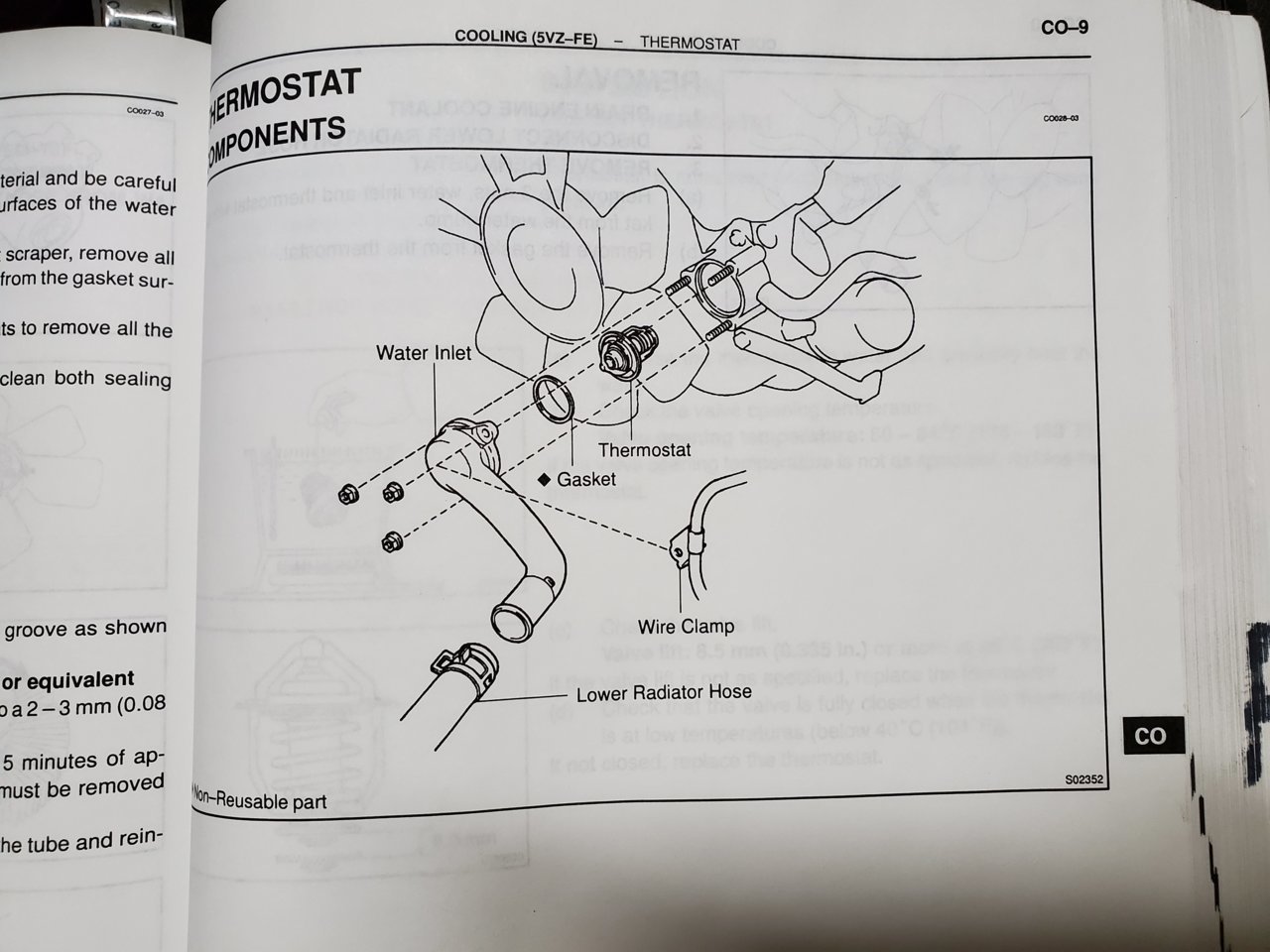

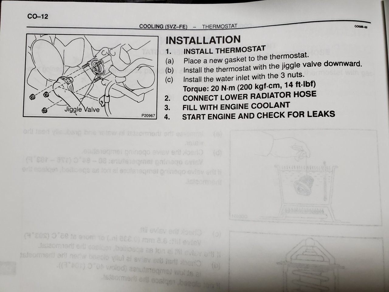

    jiggle valve goes downward

    Can't make it any easier than this...

    Practice what exactly? If you have to practice removing and installing 3 nuts, then we should probably be having some different conversations.

    Drain coolant (petcock on bottom driver side of radiator), remove 3 nuts, remove thermostat housing, *optional remove and install of thermostat/gasket, replace thermostat housing, install 3 nuts and bracket, torque to spec (14 ft/lb) and fill with coolant.
    Everyone has to learn somewhere, and this is about the easiest job you could possibly learn on. No need to wait for a junkyard rig to practice on. Just give it a shot. Worst case scenario, you get a leak and have repeat the process. Bottom line:
    YOU CAN'T MESS THIS UP!
