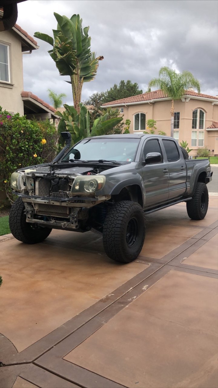

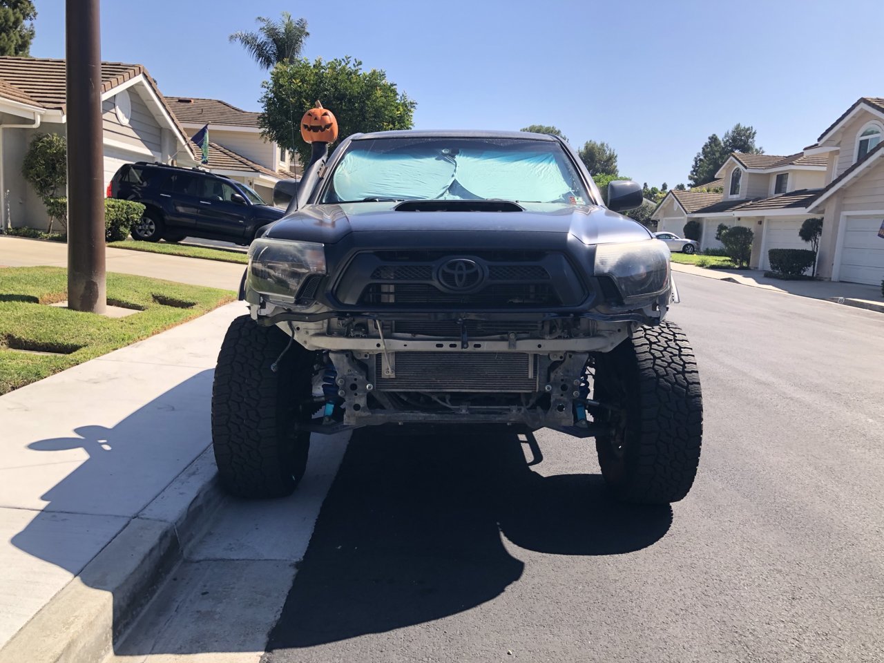

    Hey guys! I just did the swap for this, so I figured I would post a complete, up to date list of all the parts you need, and working links!
    I have videos up on my Youtube channel doing the swap: https://www.youtube.com/channel/UC2-zEw3n14WcGnvdBV8vdWg?view_as=subscriber - My Instagram is @socalexpeditions if you need any help. Shout out to @anthony250f for helping me!
    The parts list is for a Tacoma who does NOT have a stock bumper! This list is incomplete for those who want to run a stock bumper. I have an aftermarket bumper, so I did not need a crash bar as well as the brackets for them! However, this list is complete if you plan on running a plate bumper!
    Total Cost: $622.02 + $10 on Krylon Fusion Satin Black Spray Paint
    Parts List:
    -12-15 Tacoma Hood. I purchased mine off Craigslist for $160. There are some on eBay. You will have to choose whether you want one with a scoop or not. I chose with a scoop!
    -12-15 Tacoma Grill. I purchased mine off Craigslist for $20. There are too many options out there, so you pick which one you want!
    -12-15 Tacoma Headlights. I purchased mine off Craigslist for $50, then retrofitted them (video on Youtube of that). If you want new ones, I recommend DEPO. However, OEM is best!
    -Hood Scoop: Genuine Toyota 4Runner Tacoma Hood Scoop Bulge 76181-35902 OEM - https://www.ebay.com/itm/Genuine-Toyota-4Runner-Tacoma-Hood-Scoop-Bulge-76181-35902-OEM/323379448849?ssPageName=STRK%3AMEBIDX%3AIT
    -Hood Scoop Guide: Genuine Toyota Scoop Guide 76182-35080 - https://www.ebay.com/itm/Genuine-Toyota-Scoop-Guide-76182-35080/372535600063?ssPageName=STRK%3AMEBIDX%3AIT
    -Outer Bumper Bracket: Bumper Bracket For 2012-2015 Toyota Tacoma Bumper Bracket Outer Set of 2 - https://www.ebay.com/itm/Bumper-Bracket-For-2012-2015-Toyota-Tacoma-Bumper-Bracket-Outer-Set-of-2/371682886437?ssPageName=STRK%3AMEBIDX%3AIT
    -Upper Retainer (YOU NEED 2X OF THESE): Genuine Toyota Upper Retainer Retainer 52531-04010 - https://www.ebay.com/itm/Genuine-Toyota-Upper-Retainer-Retainer-52531-04010/254335274050?ssPageName=STRK%3AMEBIDX%3AIT
    -Brace Assembly: Genuine Toyota 53209-04020 | BRACE SUB-ASSY, HOOD - https://www.ebay.com/itm/Genuine-Toyota-53209-04020-BRACE-SUB-ASSY-HOOD-Part-5-On-Picture/223638812087?ssPageName=STRK%3AMEBIDX%3AIT
    -Headlight Filler: LH RH Headlight Filler Set For 2012-2015 Toyota Tacoma TO1088118 - https://www.ebay.com/itm/New-LH-RH-Headlight-Filler-Set-For-2012-2015-Toyota-Tacoma-TO1088118-TO1089118/183217265339?ssPageName=STRK%3AMEBIDX%3AIT
    -Front Bumper Mounting: TOYOTA 2012-2015 TACOMA FRONT BUMPER MOUNTING BRACKET CENTER RETAINER 3PC - https://www.ebay.com/itm/FOR-TOYOTA-2012-2015-TACOMA-FRONT-BUMPER-MOUNTING-BRACKET-CENTER-RETAINER-3PCS/121205318036?ssPageName=STRK%3AMEBIDX%3AIT
    -Expensive Clips for Headlight Filler (YOU NEED 2X OF THESE): Toyota OEM Upper Quarter Trim Clip 90467-10188 - https://www.ebay.com/itm/Toyota-OEM-Upper-Quarter-Trim-Clip-90467-10188-Factory-Sold-Individually-Various/123063068983?ssPageName=STRK%3AMEBIDX%3AIT
    -Headlight Assembly Clips (YOU NEED 2X OF THESE): Toyota OEM Headlamp Assembly Mount Bracket 53271-0B010 - https://www.ebay.com/itm/Toyota-OEM-Headlamp-Assembly-Mount-Bracket-53271-0B010-Factory-Various-Models/123164777138?ssPageName=STRK%3AMEBIDX%3AIT

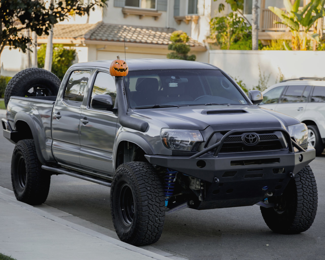

    5,387
    Updated finished photo!
