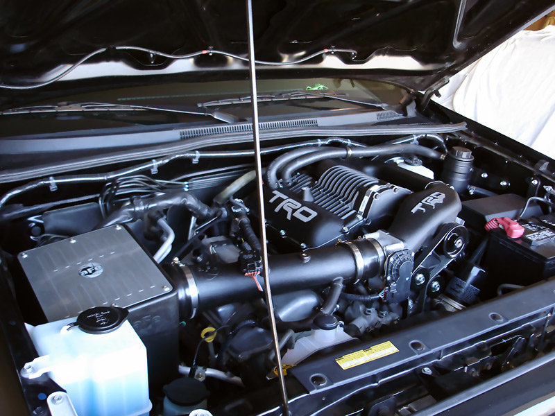

    Of course I took a pic!
    The supercharger is awesome! I was surprised how complete the kit was and how it ALL just bolted up. Crank bolt was the hardest part.
