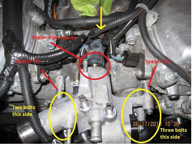

    I'm installing mine now and spent 3 hours trying to get the thermostat housing over the water pipe seal. I've attempted installing it over and over, even tried it just putting the extension on by itself. The actual extension will not go over the water pipe seal.
    Any ideas what I'm doing wrong? Tips or tricks?.... Using grease, and it's on 2k15 truck with ~500 miles. It feels like the seal is a size too big as it just pushes over the lip on the water pipe.
    Any help is appreciated!

    That thing is really tight. I made the mistake of putting the extension onto the water pump first. Then having to juggle the whole thing on. It goes onto the water pump a heck of a lot easier.
    One trick was in the instructions about keeping it straight. Any angle makes it harder. Then I just used my fingers to work that o-ring in. Lube is important. And the o-ring wants to poke out all over, especially the bottom where it's harder to detect.

    Tried that, will try again today. I have another set of hands to help today as well, hopefully that will make a difference.
