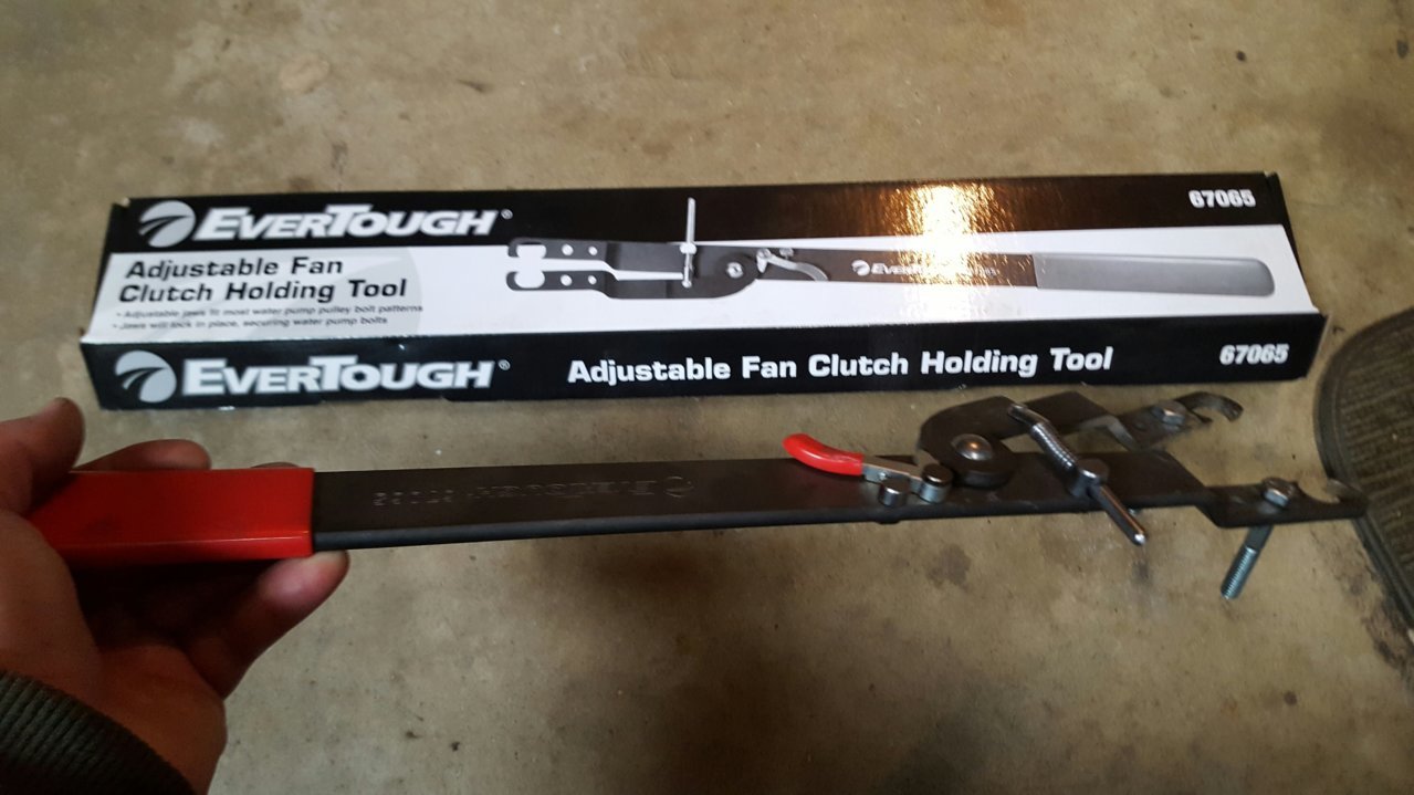

    Finished my install this week. Hardest part was figuring out how to hold the crankshaft pulley for torque on an automatic trans. Found this loaner tool at O'REILLY auto parts that worked perfectly.
