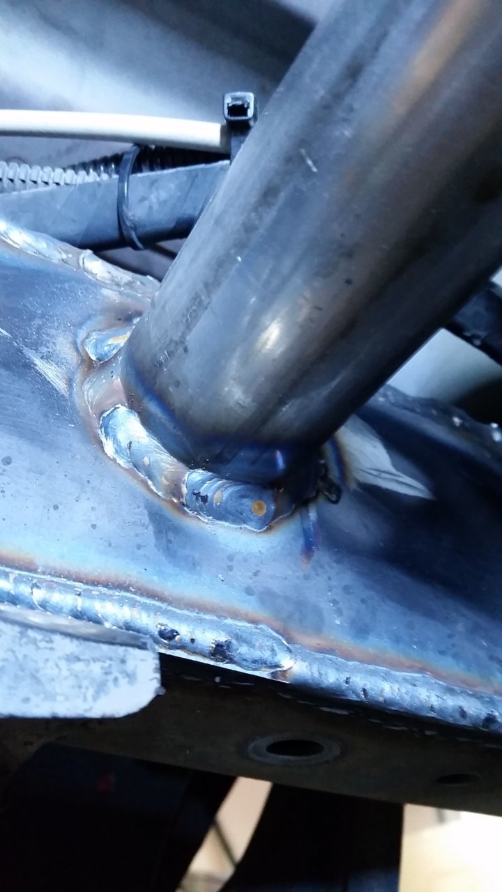

    Just went to the metal yard and got some 10ga sheet metal, then measure the inner c channel, cut and weld in place and 1.75 tube for reinforced

    How did you decide where to place the crossmember? Did you just measure the distance between the frame and the bed at different points and find the smallest place it would fit completely?

    It's base on what angles you are trying to get from measuring droop and full stuff for the shock mount and then the reinforced 1.75 tube is what ever my shock reservoir mount the best
