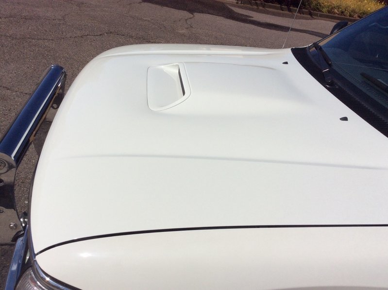

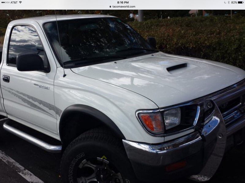

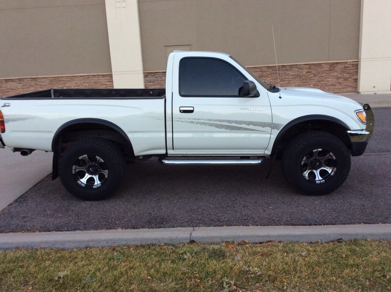

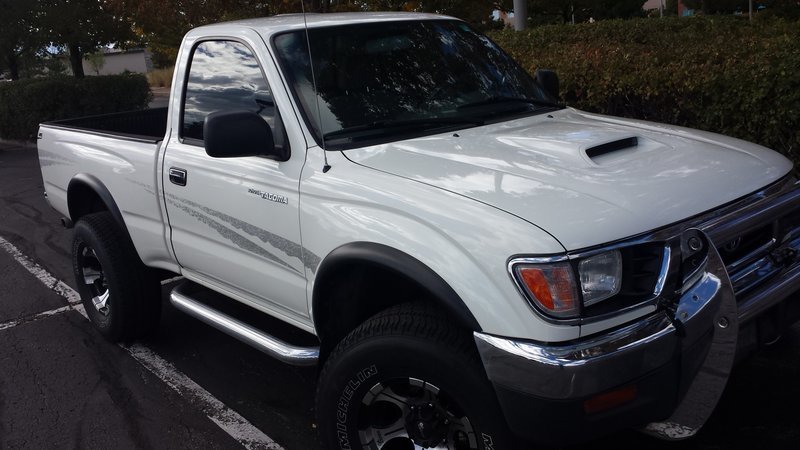

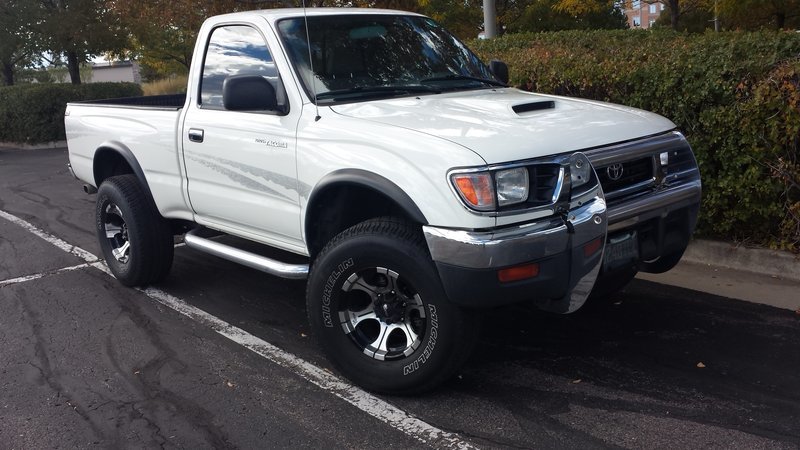

    Came out perfect and chopped the fiberglass insert end off and is totally functional

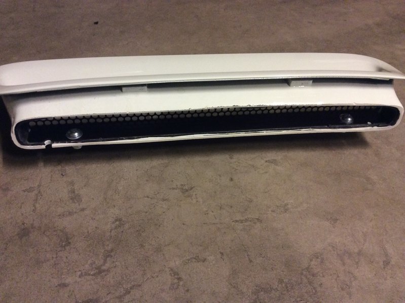

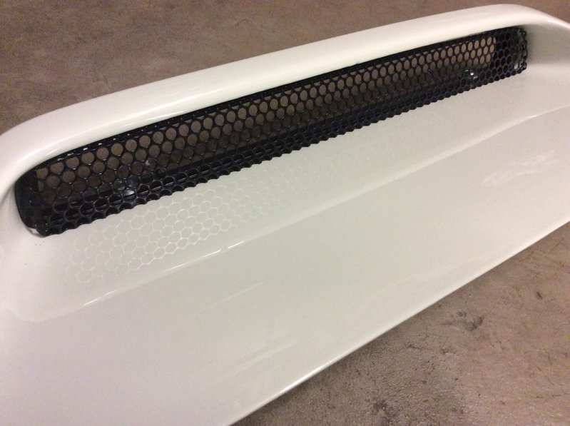

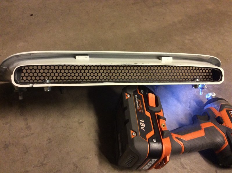

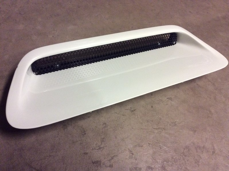

    A few last photos of the scoop,
    I cut the very back section of the fiberglass scoop insert off 1/2" in from the back just In front of the drain holes.
    Also cut the back section of the plastic inset and then screwed it together with lock nuts after I put a fresh coat of black paint on. As you can see it is now completely opened.
    The scoop inlet air hole lines up perfectly just in front of the supercharger

    One thing to note about a functional hood scoop with a supercharger that I'm finding out is the sound comes out of the scoop and because of that the charger is louder.
    You can listen to the sound clip below.
