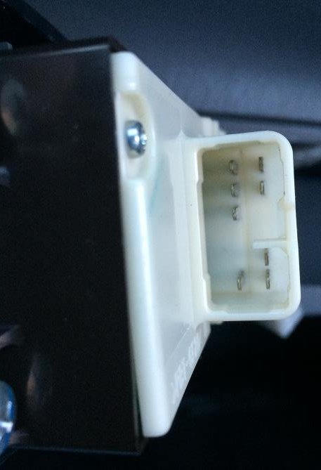

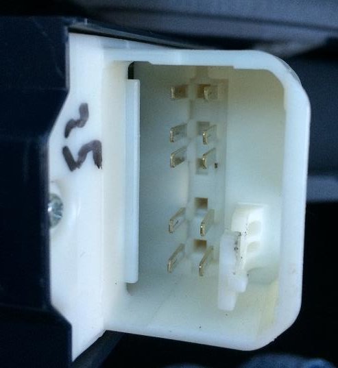

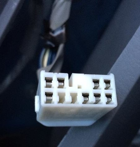

    I took some pics of what I have to work with, hoping it might help.
    door wire harness plug:
    current 2010 switch port:
    2012 switch port, its bigger with 2 more pins:

    I knew the 2012 regular/access cab harness was the same size as the one for the double cab, but I didn't know the older regular/access cab harness was smaller. The pin swap method won't be possible. It will be necessary to obtain the larger harness and move the pins into it.

    yeah I already tried to get the plug for it with the unit but no one really has just that little bit of the door harness. im not sure what to do about it now without knowing what male/female adapter plugs I need to get.
