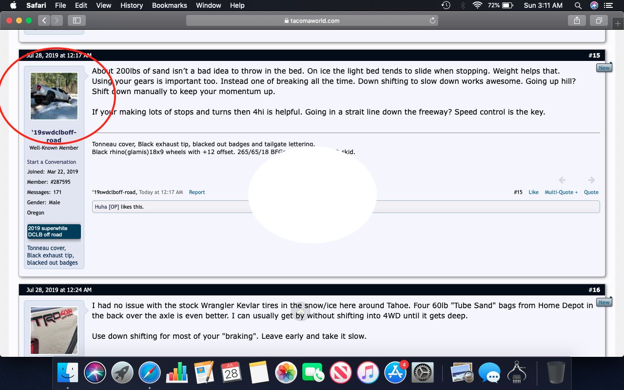

    The irony of his comments and avatar pic.
