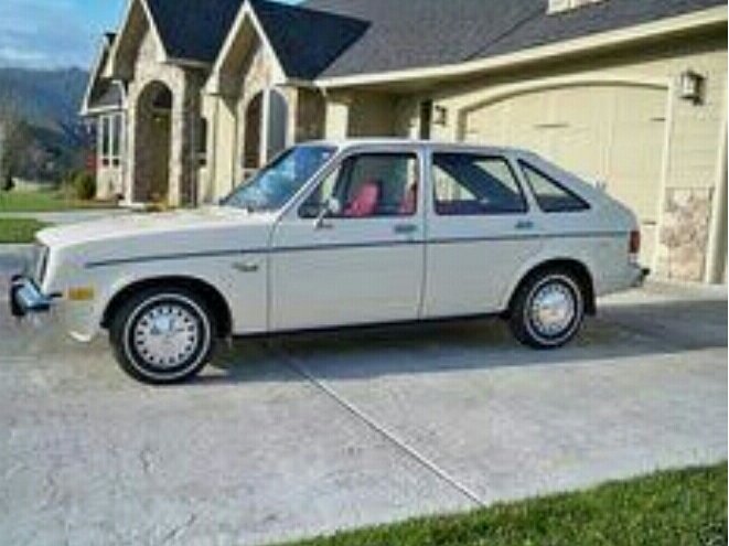

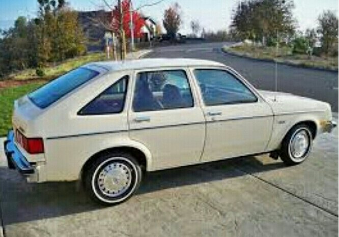

    I drove thru many a snow storm in a ‘81 Chevrolet Chevette...slow down and don’t be an idiot and you’ll certainly be ok in a 4x4 Tacoma.
  15. Jul 29, 2019 at 9:27 PM
    #95
    G8R_Taco
    G8R_Taco Just passin thru….
    Jun 8, 2019
    #295798
    1,667
    FLA
    2019 TRD OR 4x4
    Dude. The heat from the firewall and floor board was intense on those old rigs! My buddy had one. He ditched it. In a ditch...
