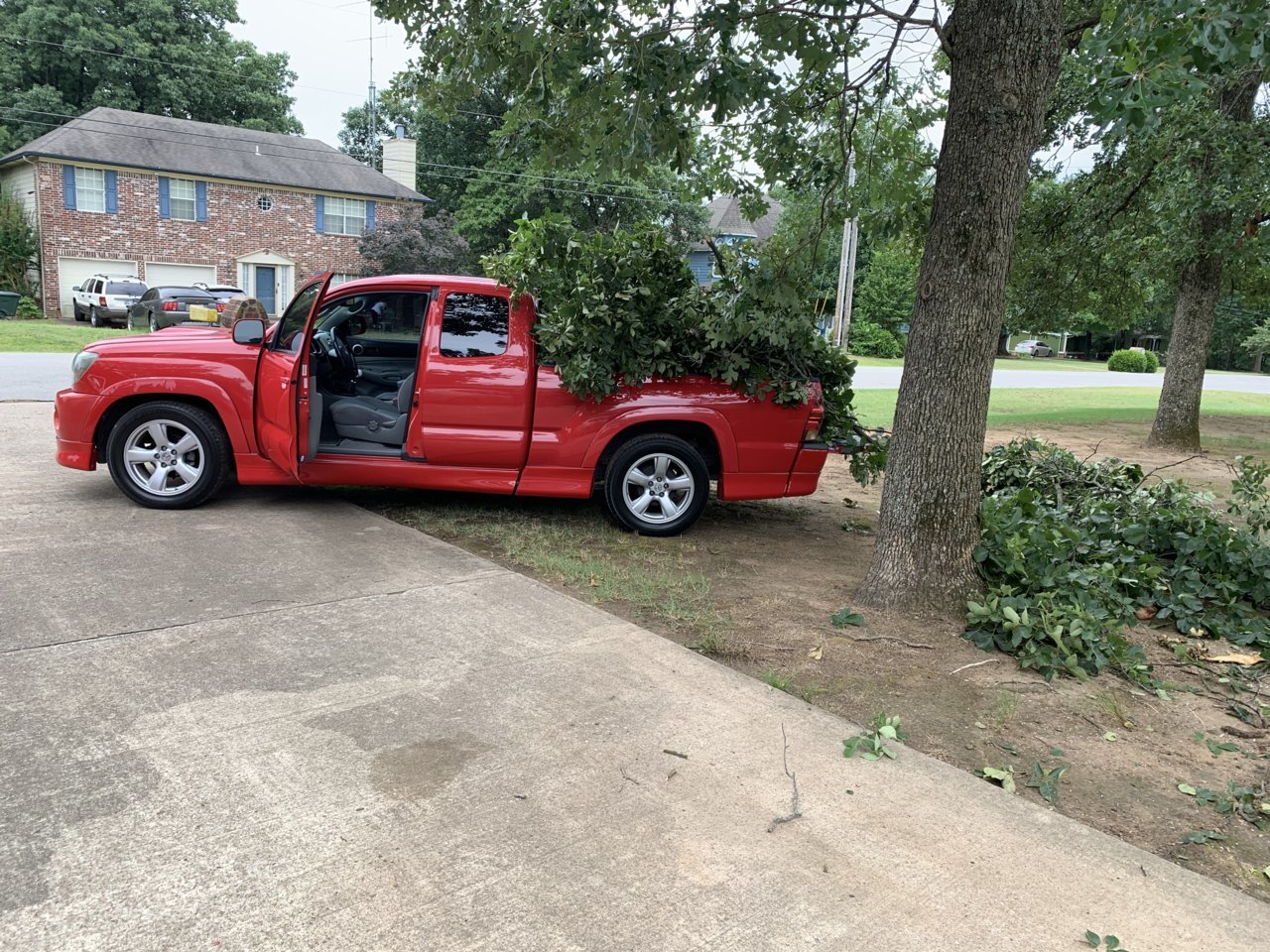

    No but he gives great guesses I’ve been a licensed mechanic since 1978 so I’ve seen different oils. The great GL4 vs GL5 debate is pure horse shit. The GL5 is backwards compatible except in transaxles that operate at high temps. Your Toyota trans is not one of them. Also check the specs GL5 meets and exceeds specs for GL4. Personally I made the switch to Redline MT90 for my 2006 X Runner before it reached 100k miles and the shifts improved became more smooth and I left it in when I sold the truck at 145k a few years ago. Sometimes wish I had it back because although it was useless as a hauler it was fun to drive. Here it is doing yard work.
