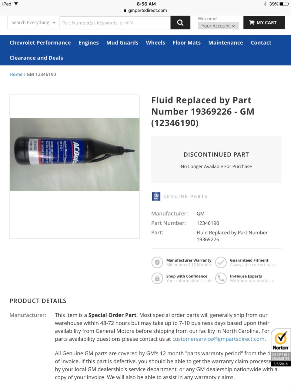

    Grossomotto Complete 3rd Member
    Mar 13, 2018
    #247175
    8,446

    Taco'09 is this what you are referring to?
    scottalot likes this.
  20. Jul 8, 2018 at 7:08 AM
    #120
    Taco'09
    Taco'09 Well-Known Member
    Dec 31, 2008
    #12073
    1,876
    Yes indeed. The new part number has me bugged at the moment as I do not know why it has been done. I hope the formula or specs have not changed. It also has an ACDelco part number of 10-4059 and I have found about 8 qts. It also has Chrysler/Mopar part number but I would have to dig for that one but I'm told it is pretty pricey at the Dodge dealers.
    This stuff really is that good IMHO.
