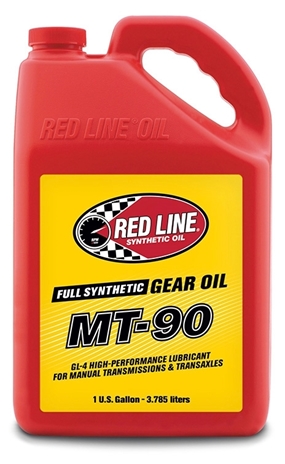

    for those in need......
    GL-4 oil (MT-90)

    got it today

    The best a trans can get.
    I’ve also mixed this with RL MTL with great results.

    Ive been running Lucas 85w140 in mine for a while now. I like it more than the redline mt90

    Note about oil choice. I’ve circled back and done some research on this, seems like at some point Toyota clarified the spec for the gear oils. The latest info for the 2nd gens is as follows:
    Differentials: 75W-85 GL-5
    Manual transmission: 75W-90 GL-4
    Transfer case: 75W-90 GL-5
    As some point Toyota used to spec GL-4 or 5 for the transmission, this is no longer the case and you should ONLY use GL-4. This would be the redline MT-90. Using GL-5 in the transmission will prematurely wear out the synchros. And using GL-4 in the differentials will prematurely wear out the diffs. The transfer case and differential oils should be the standard GL-5 gear oils that Redline sells
