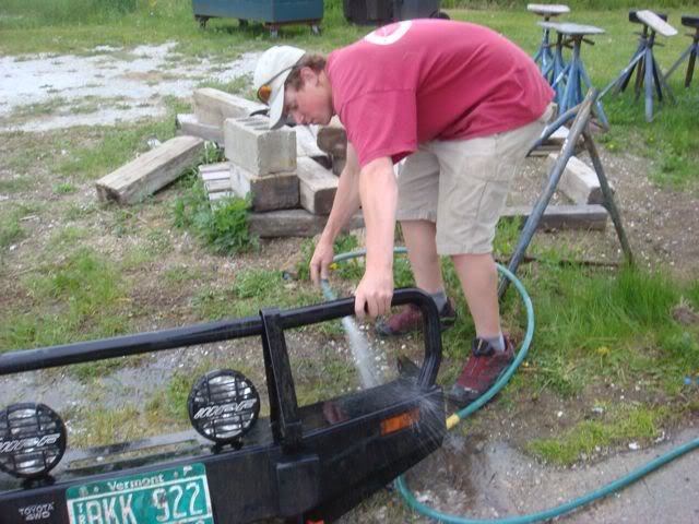

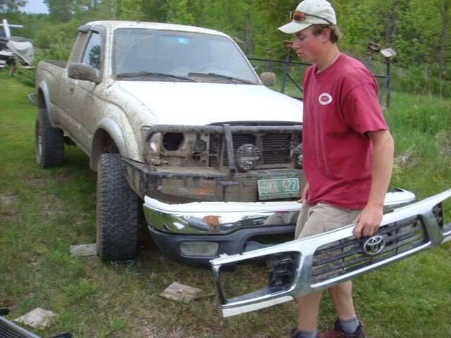

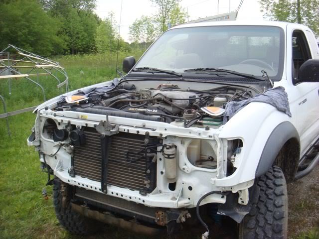

    Started with 2 trucks:

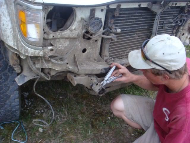

    Removed the hoods, lights, bumpers, and grilles from both trucks:
    DSC01841_b818757388d6058bf7c255ba3ac6fbd4c6d5b614.jpgDSC01839_607e6fcb054d4fce183ca5e4f1fe90da9bd6040c.jpgDSC01847_f68bfd077b8e17637ce3537ec45570077131876d.jpg

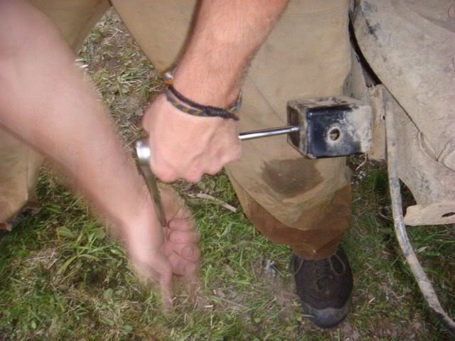

    Swapped the hoods and put ARB mounts on the new truck:
    DSC01848_ac5ea745785a673562b6ffc70dcf502e96ca3d74.jpgDSC01850_95a25e64af570bd4b575771cfa0eb1b102336dce.jpg

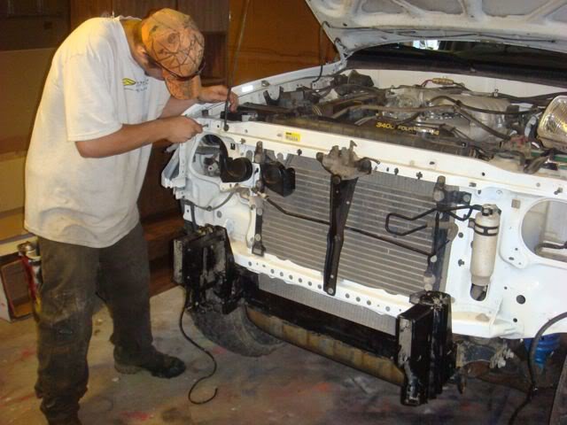

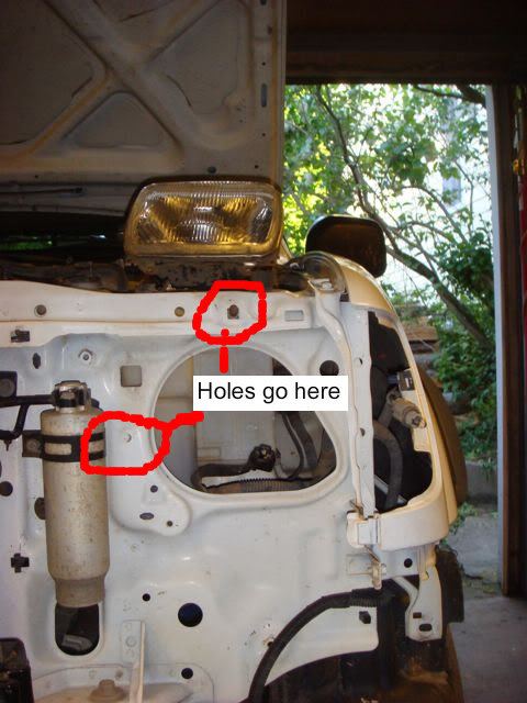

    Then moved the truck to a garage and started on the old-style headlight mounts on the new truck. This involved drilling holes in the body panels for the mount/aiming screws and squaring them out with a file. One went behind an existing hole on top of the light, and the other had to be marked and drilled afterward to ensure correct placement.
    Filing:
    DSC01853_a35769673491a3ed36846ca3b09708d3a7650c80.jpgDSC01854_1b30b536d98fcd679244886eedfba9fdfde49d5c.jpg
    Once the square plastic screw mounts fit, I put them in the holes and added epoxy to make sure they stayed put. Left them to set for the night and day and finished the next evening...
    The grille clips are all the same for both styles, so the only modification needed was a little filing on the left side of the main grille part to make it fit in front of a cooling system hose. Then it just slid right on. I also used zip-ties to hold the grille in place because the OEM clips suck and always break after 1 use. It's much easier to use zip ties and just cut them off each time.

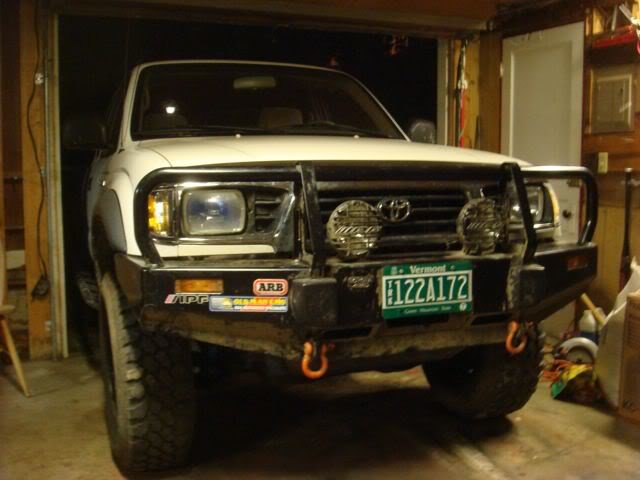

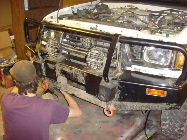

    ARB mount process, with lights and grille all in place:
    There you have it! All finished. Now I have a truly unique truck, not to mention I rid myself of that billet grille.
