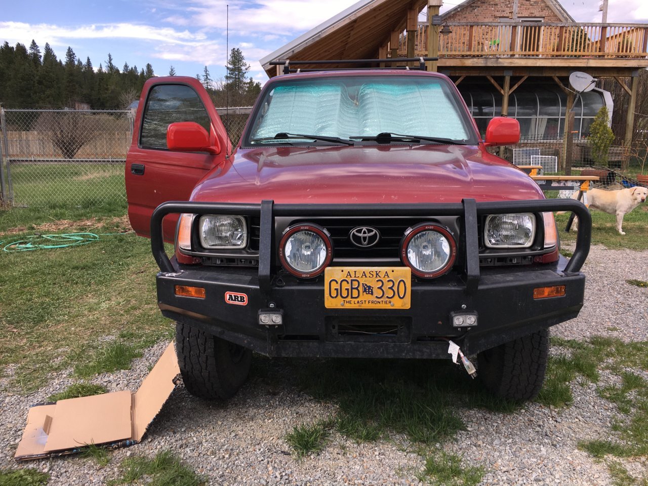

    FYI, using the old plastic headlight buckets (thanks Madjik) worked relatively well. You end up having a lot of trimming to get to fit. I used a set of aftermarket adjustment screws (eBay- came from Thailand) and inserts. I suspect I will replace them with an OEM set - kinda cheap, but for short term should do. Longer adjustment screws would be nice,
    I bought a set of used headlight brackets and rings and two springs on the bottom- outer spring pulling down, inner pulling up. You remove the round knob bolts that the plastic headlight snaps onto, and some m6 x1.2? bolts threaded in from the backside , a screw mount made out of about 2-1/2” piece of plumber’s tap folded in half, a serrated locknut to secure it. (If you have better quality PT a single piece might do, just doubled it in case) Still have to get the little inserts for the corner lights....

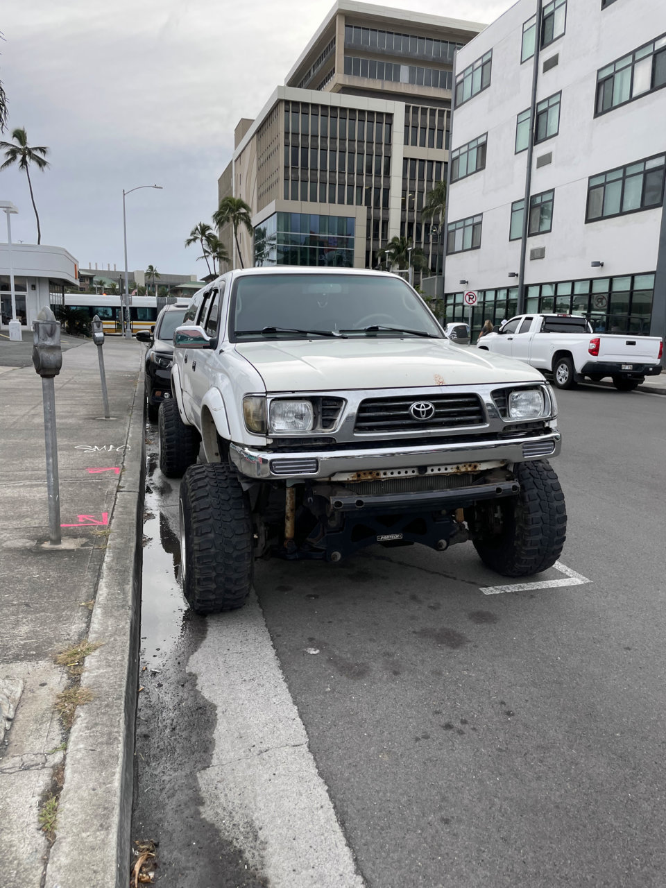

    Not the best photo. Had to work out a bunch of quirks, still working on it. I must've drilled the horizontal screw a little too low as the headlight brackets are only in place by the horizontal screw and a spring in the top outside corner on both. The grille is holding them in place and all with zipties.
    Also decided to go with a 2wd bumper and looking for a chrome valance. If you plan on keeping a stock bumper you need the bumper brackets from a 95-97 as well.
    As far as corner lights will probably buy a set for 95-97 with the screws and just purchase the plastic screw mounts.
